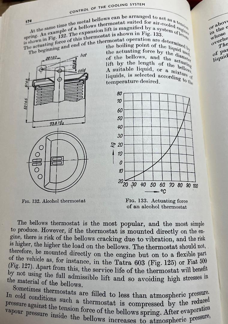

Julius Mackerle designed that v8 engine and later in the 60’s wrote the definitive engineering text on air cooled engines. 2nd edition became available in an English in 72’.
Want to know how much force a bellow type thermostat can exert on cooling flaps? It’s in there.
