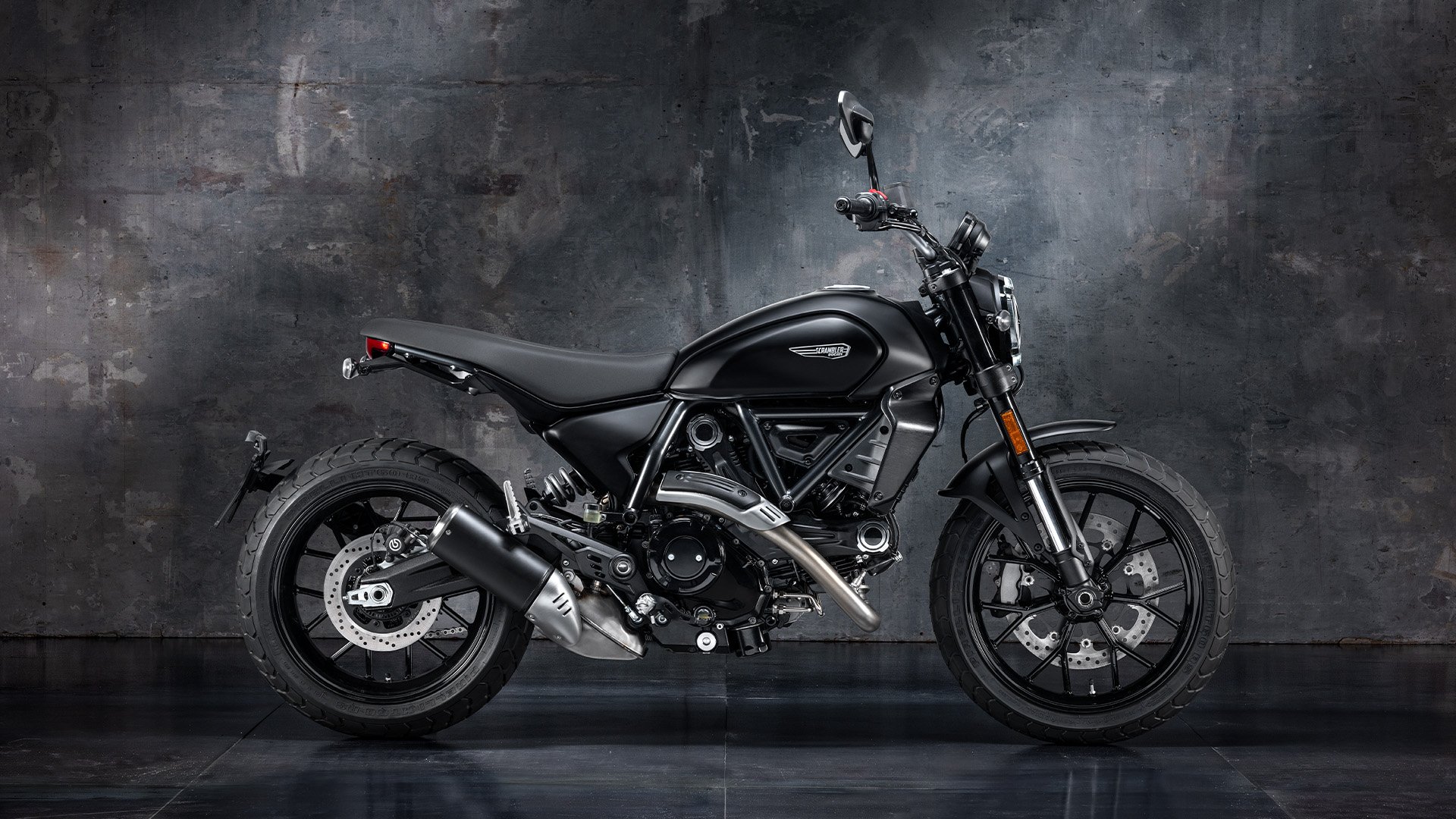

Is anybody making an air cooled vehicle these days?
No unless you count something like Morgan or Singer.
Air cooled engines died in the 90s for US, Europe and Brazil when they could no longer meet increasingly stringent emissions imposed on the OEMs. The last air cooled Beetle was 2003 in Mexico.
One example of an air-cooled vehicle still be produced and available in the USA. Also, L-Twin, Desmodromic distribution, with 2 valves per cylinder.
https://www.scramblerducati.com/en-us/bikes/icon-dark/
