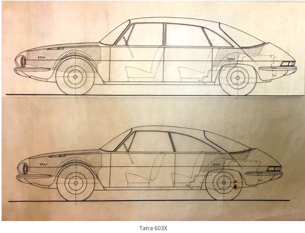

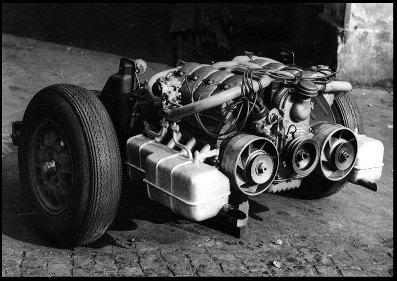

just getting back to tatras for a moment.
and to amuse @Superhawk996 because he is a man of taste as well as tech savvy.
where tatra was going but the old iron curtain economic model wasn't panning out.
the final fling of the 603. 603X. they got a running prototype up.
your regular four door!!!!! and this was in the 60s. in a communist economy for farks sake.
the power plant package. yeah.
check out the bottom drawing!!!
recently the bottom drawing was turned into a cad model in virtual reality.
remind any of you of anything?
a corvair meets a 911.
or is a corvair a part tatra and so is a 911.
who cares. because all three of them were good.
esp the second generation corvair. what a car.
those checks were trying to go somewhere.
in the same general direction as the air cooled kooks from stuttgart.
and the fan fans in GM out there in michigan. (IMG:style_emoticons/default/beerchug.gif)
its what i love about the germans.
sitting on the edge between the east and the west.
the old berlin wall.
