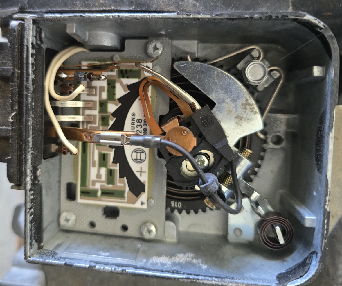

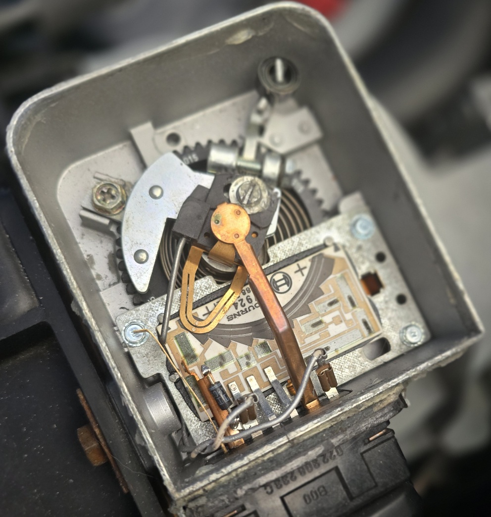

Sooooo.... I have been trying and trying to get the "on power'" AFR to be better than 10:8. I have adjusted and adjusted the big wheel to lean the mid-range to get closer to 14.1 or so, no luck.
Here is what I am working with:
I think I found the issue! I noticed when I first started messing with this AFM, that I was not the first person to open it up. The second thing I noticed was that this AFR didnt have the little tangs that lock the big wheel in place. This one appears to have a metal tab that is supposed to pinch the wheel in place. By chance I noticed the wheel could move, even if I had the screw and tab bottomed out. I moved the big wheel two teeth to lean out the on power, tightened the screw... and was about to walk over to start the car, and the wheel backed off. Repeated the same adjustment... and again it backed off. So, I think thats why I keep getting the same setting.

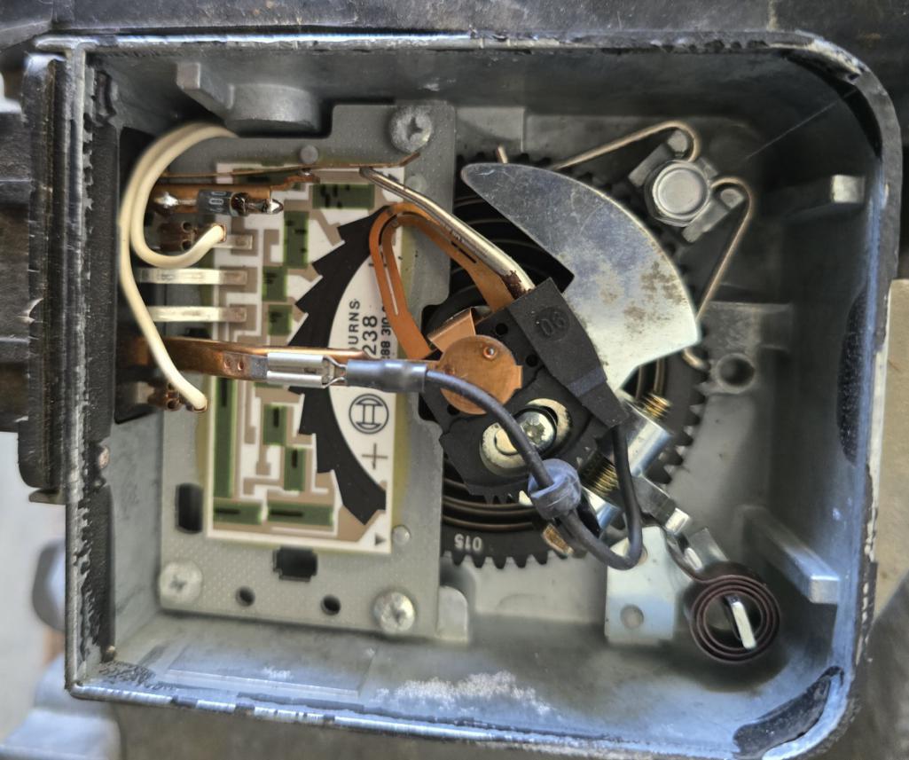

By an odd turn of events, I ended up with a second AFM! So dug it out, shook out a bunch of leaves/seeds out of the barn door/ flapper area and pried off the black lid.This unit was incredibly clean inside and did not appear to have been opened up before.

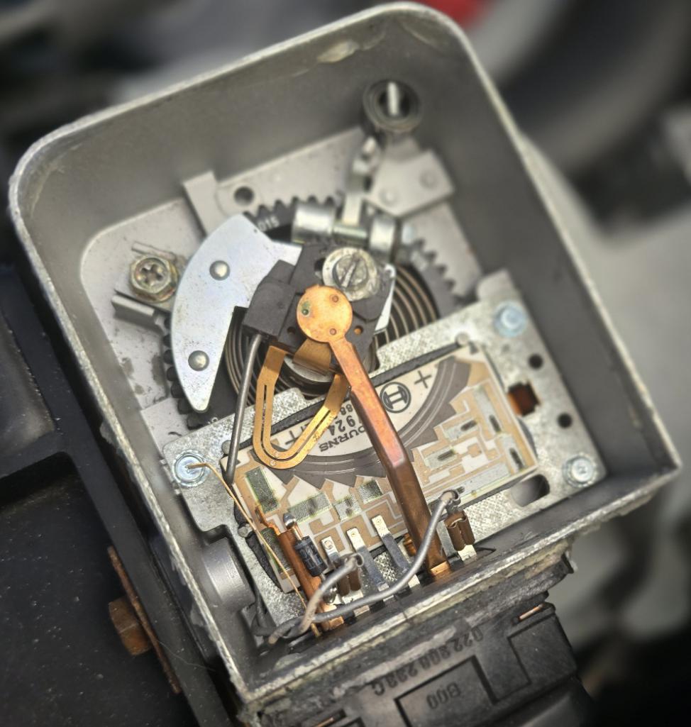

Here is thre spare I ended up with:
Notice how it has the big spring that holds the big wheel securely. I think I'm going to make sure it's clean inside the air intake are and install it to see what I get.

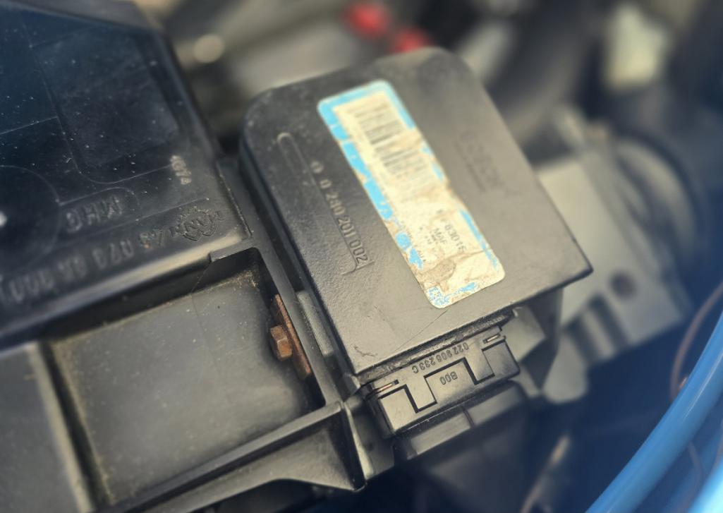

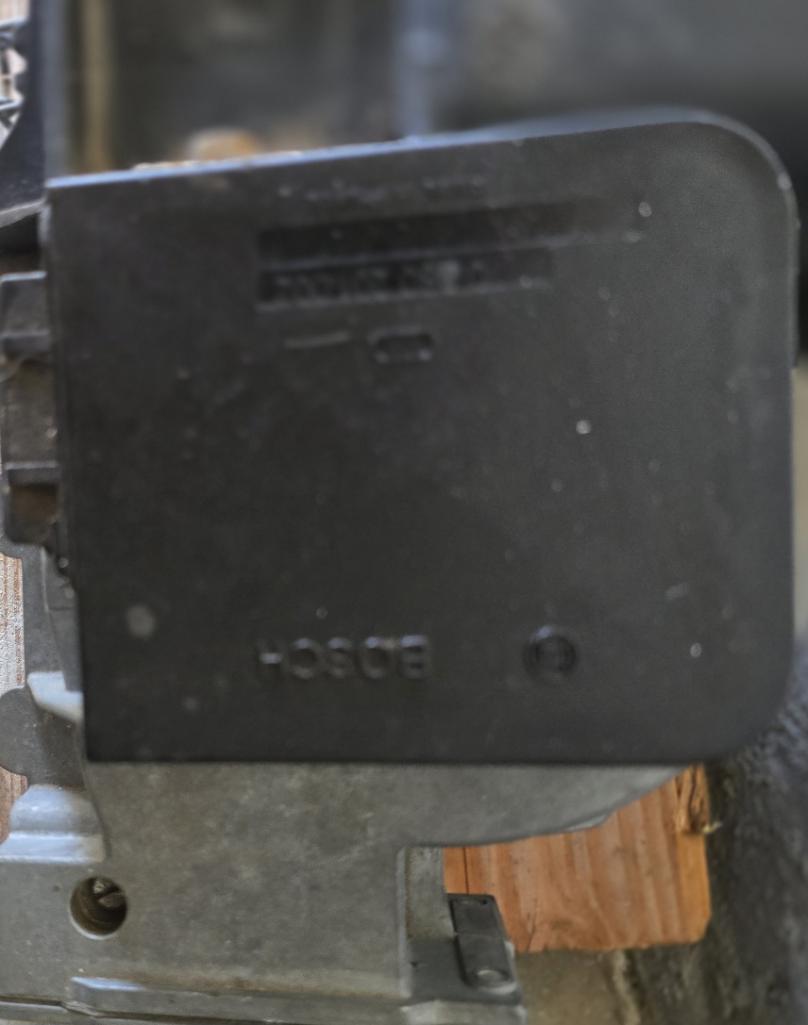

I will double check the part numbers to verify they are the same part.
