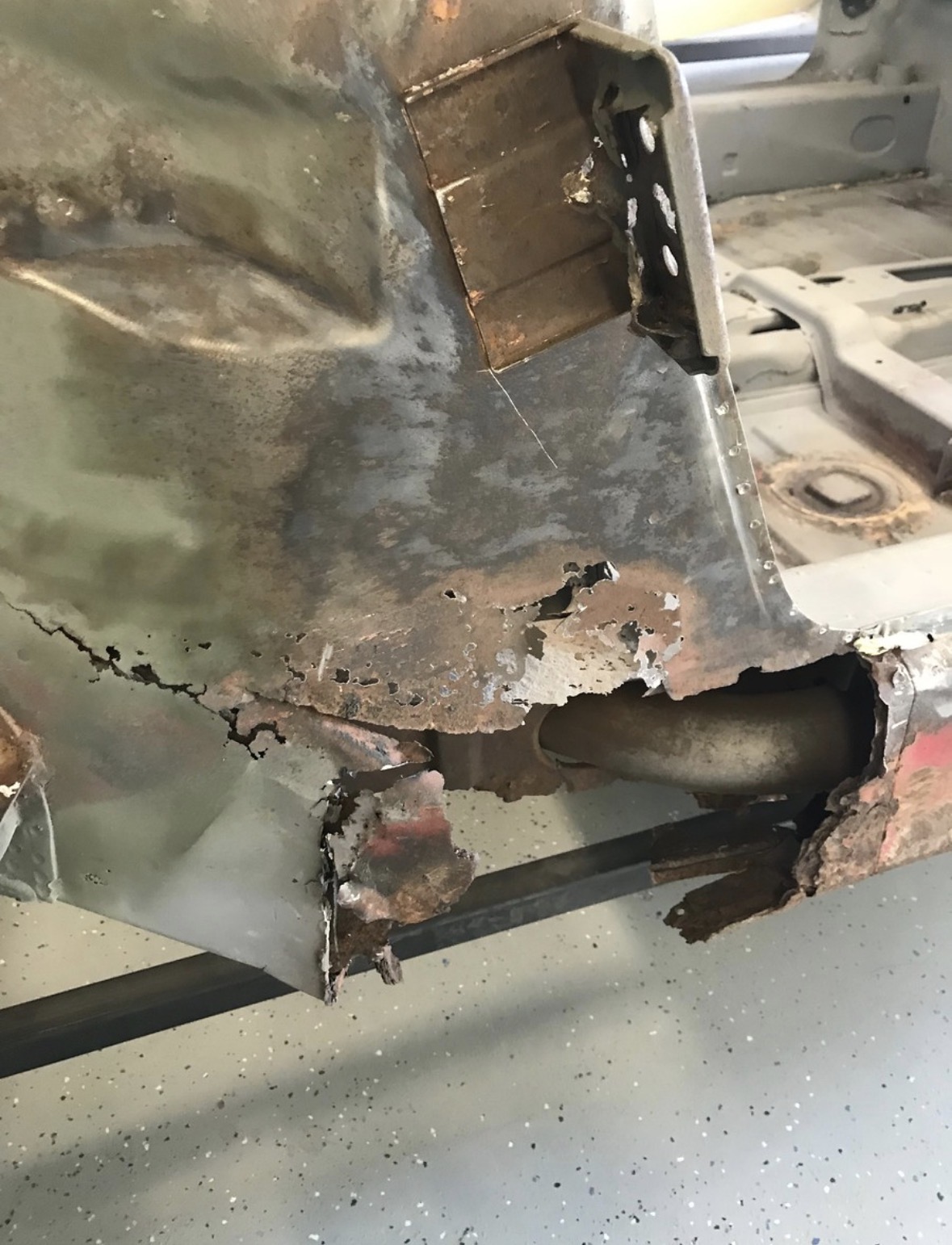

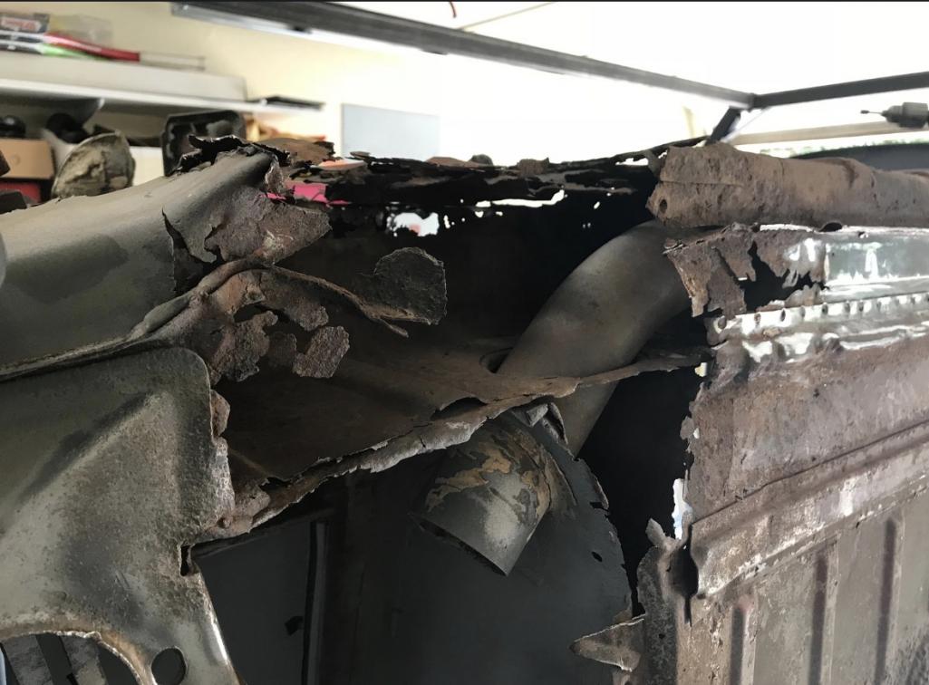

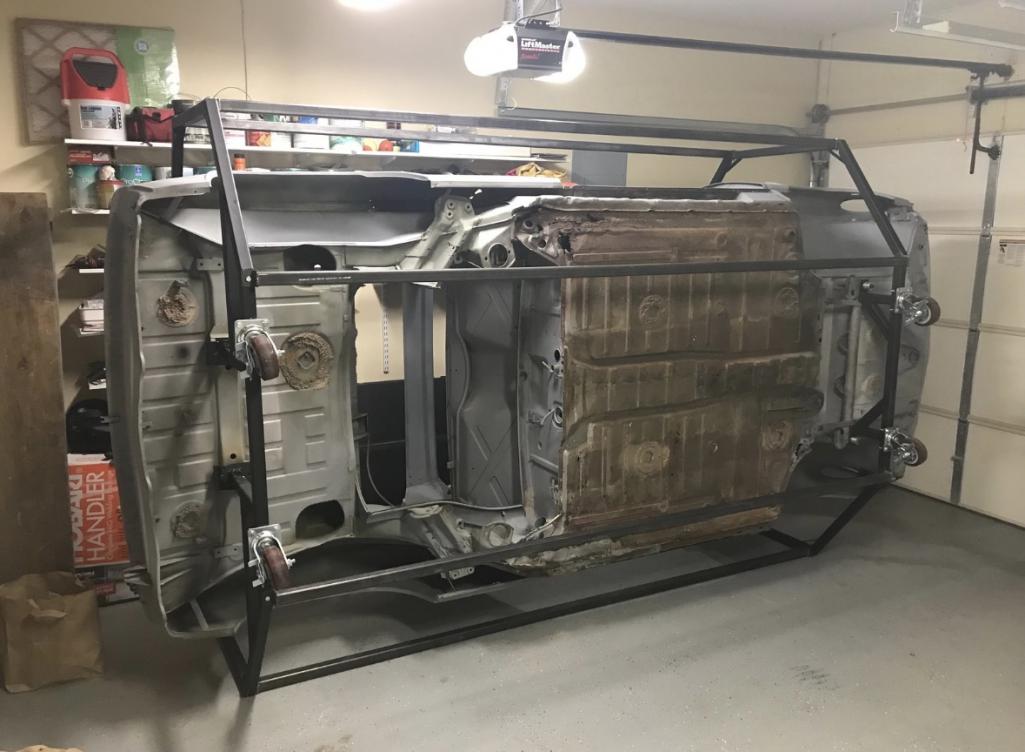

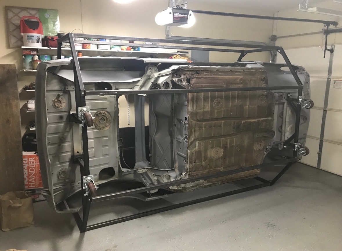

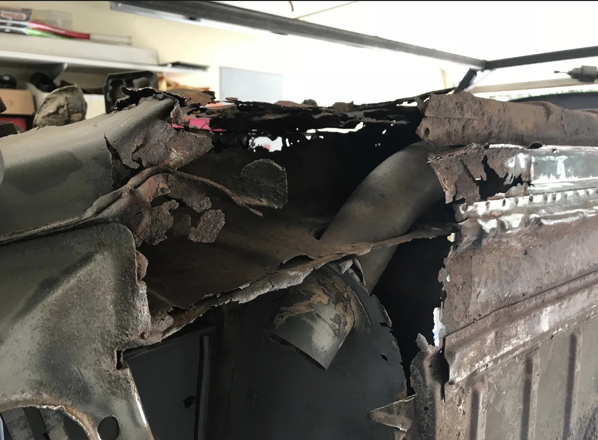

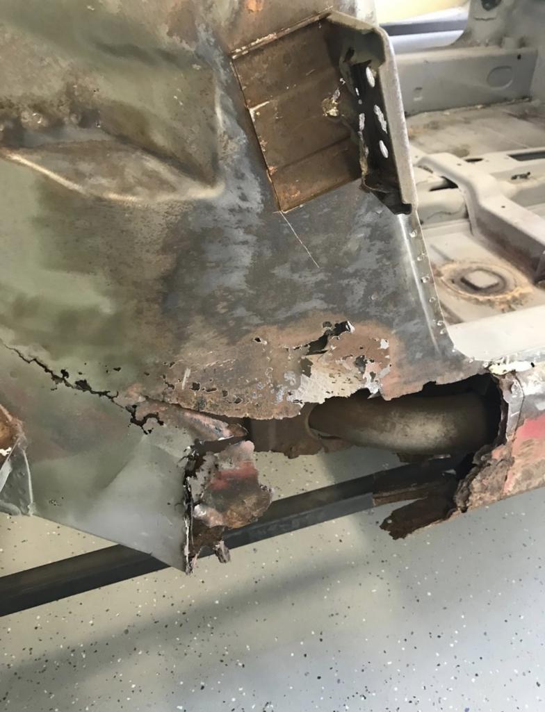

QUOTE(Ron914 @ Jun 26 2026, 05:59 PM) *
Car looks great . Did this one start out like the Bumblebee ?
Yes, it was just as “awesome” as the LE. The hell hole was especially fun. Here are a few pics - just for you (IMG:style_emoticons/default/biggrin.gif)
