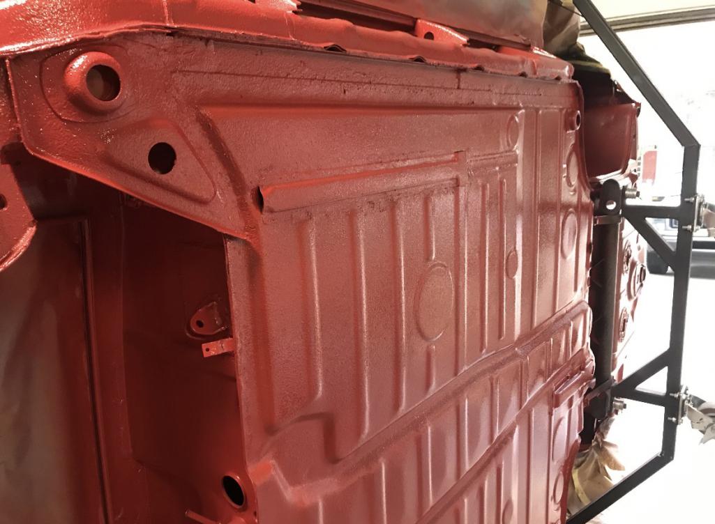

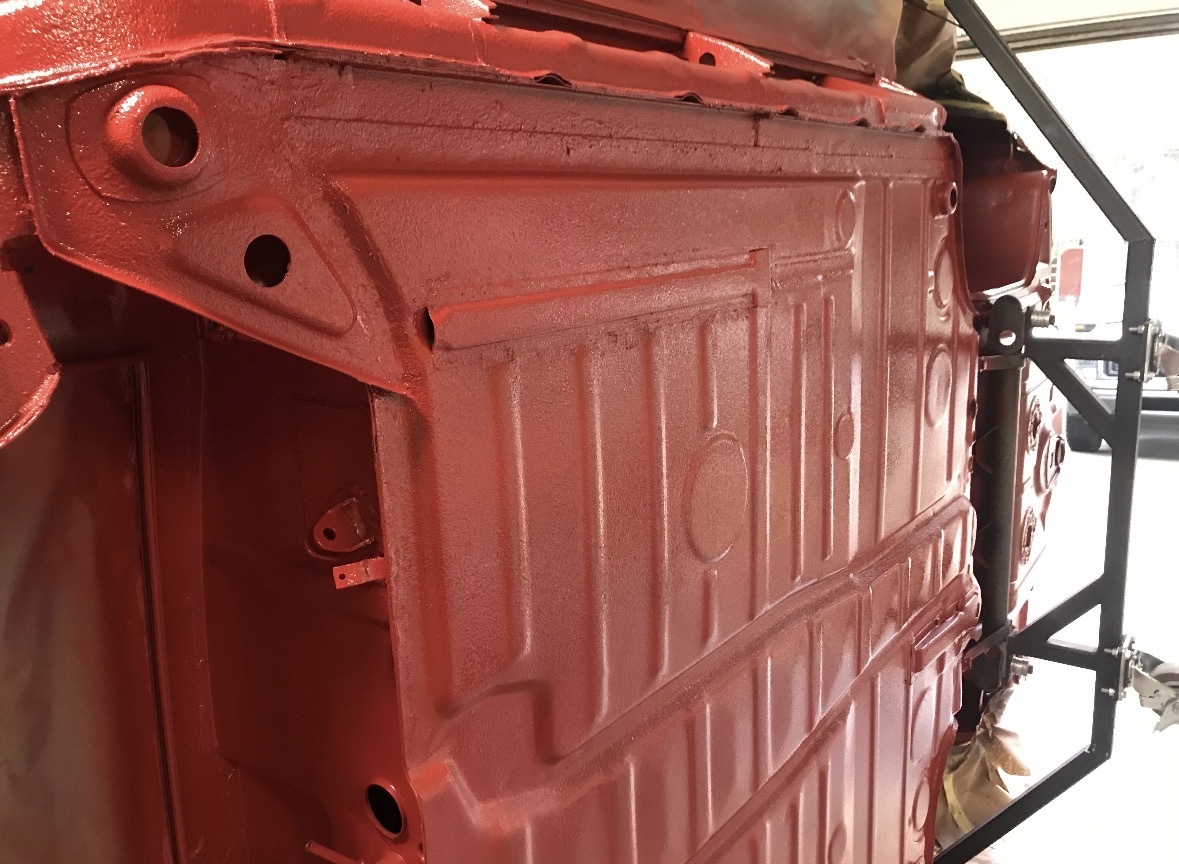

I can't believe it but after 1-1/2 years of waiting for my engine components to be machined, I am finally picking up the parts tomorrow (IMG:style_emoticons/default/blink.gif). I will post more after talking to the owner about the issues he found with my case. This is what was holding everything up. Luckily. I have source another case (from my shed) and will be using this one instead. Here's a few pics of the my "other '74" after uncovering it today and wiping off a bit of dust. She needs to ride again! Hoping for Okteenerfest. Stay tuned!
