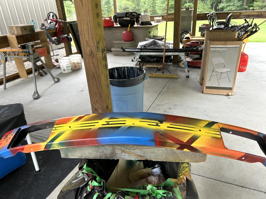

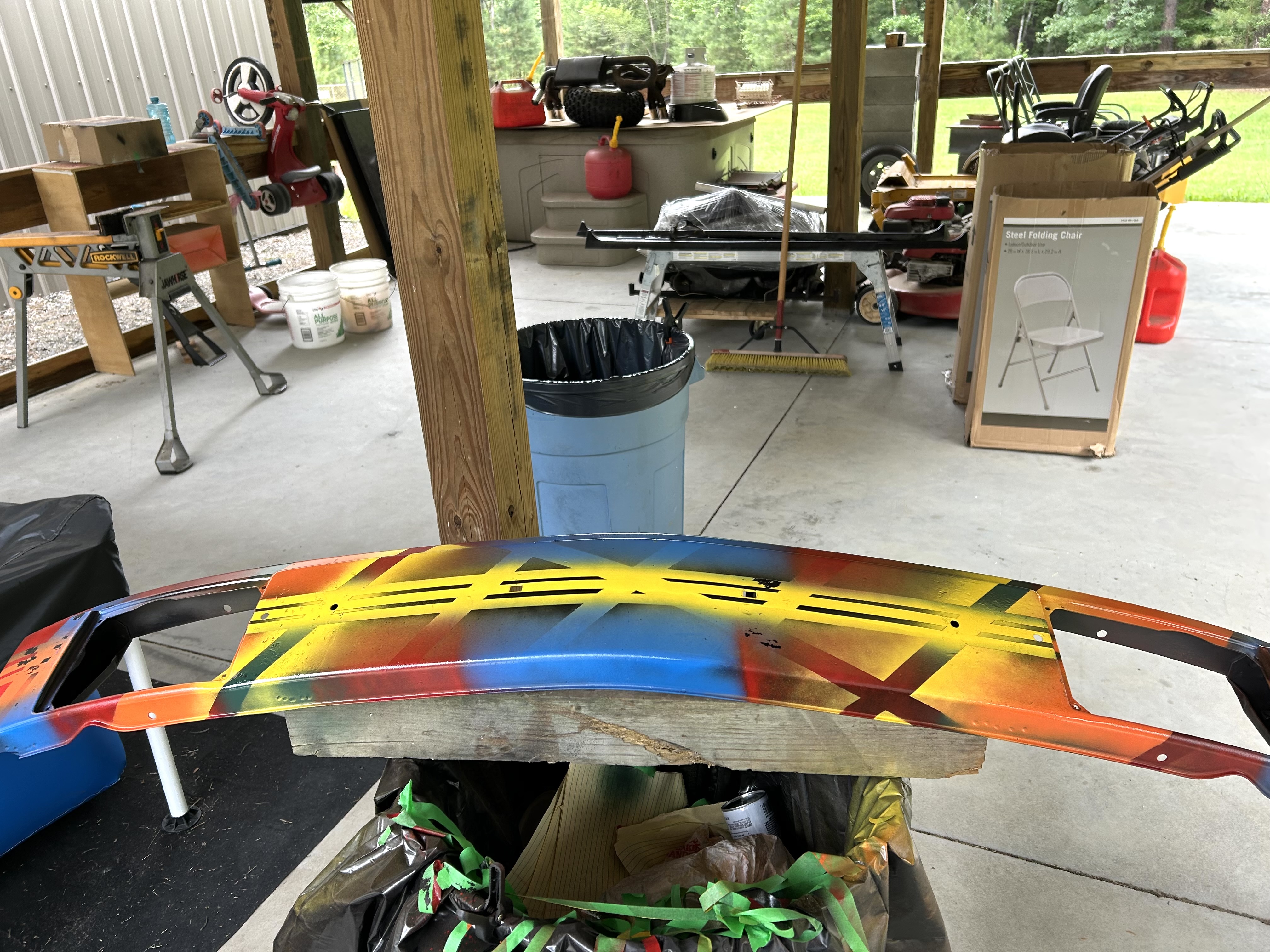

From: Virginia
Member No.: 29,151
Front bumper painted. Attached Image

HFC3   Front bumper painted.   Jun 27 2026, 11:19 AM
HFC3   Temporary installation till I can get a filler p...   Jun 27 2026, 11:21 AM
