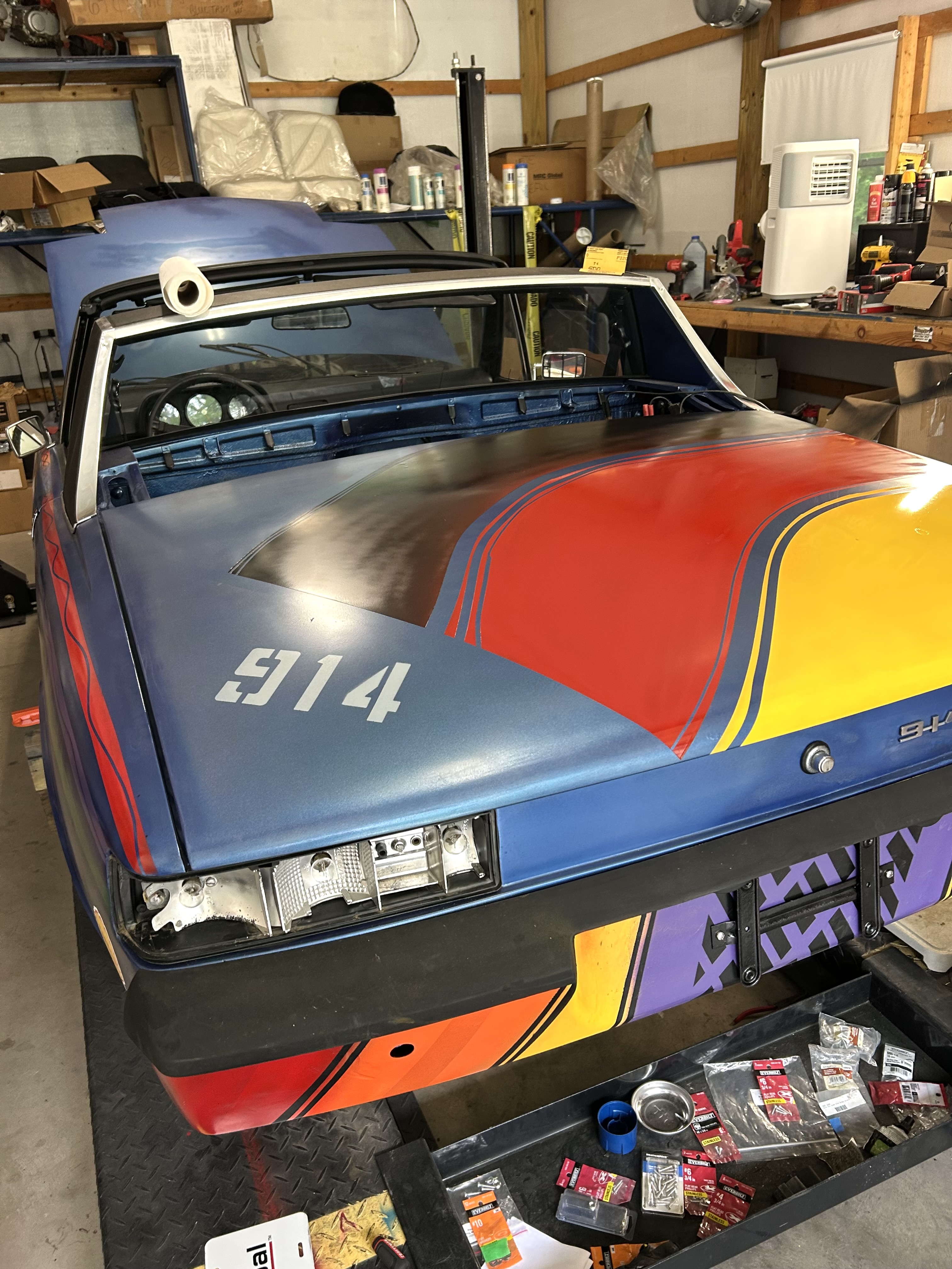

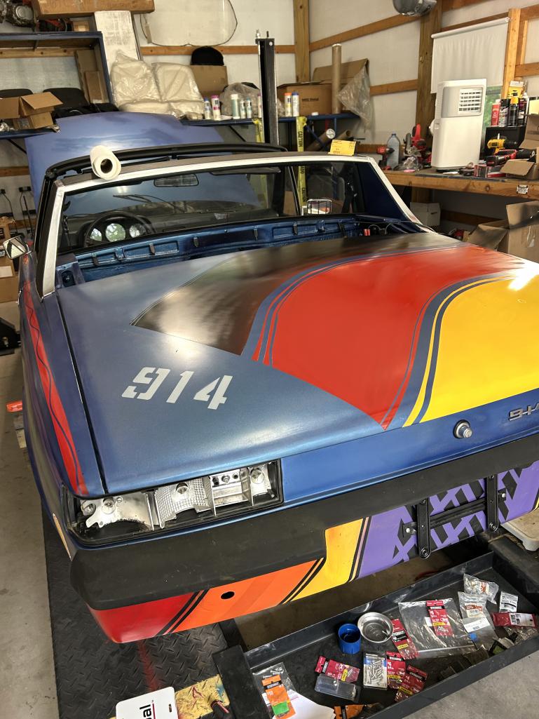

The 914 had some blank canvas left to deal with.
Remember this car had been vandalized. Dents, scratches, scrapes, all the glass broken, sail panel's ripped and the Targa top wrecked. I have replaced all the rubber seals, brake assemblies and all the rust issues cut out. Window mechanisms, door handles and locks repaired. Detailed the trunk, the frunk, wheel wells and all the under carriage. I was never going to paint this car. I wanted to protect it and cover any possible area that could rust. Someone else can paint it down the road.Attached Image
My version of the German Flag.
