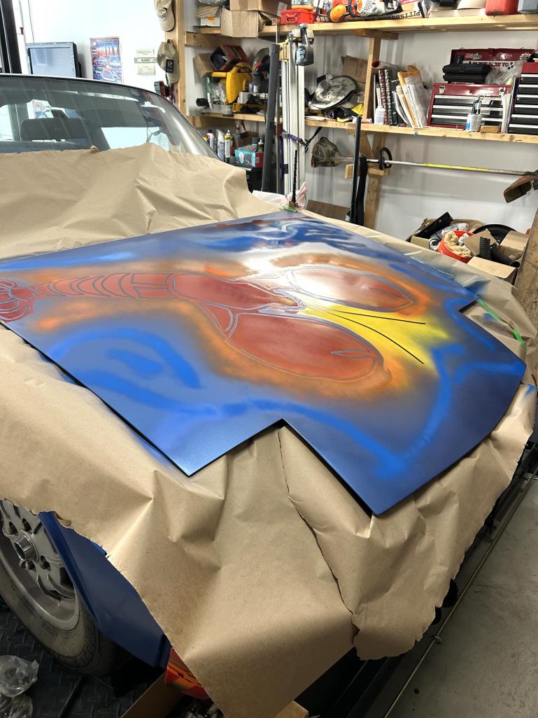

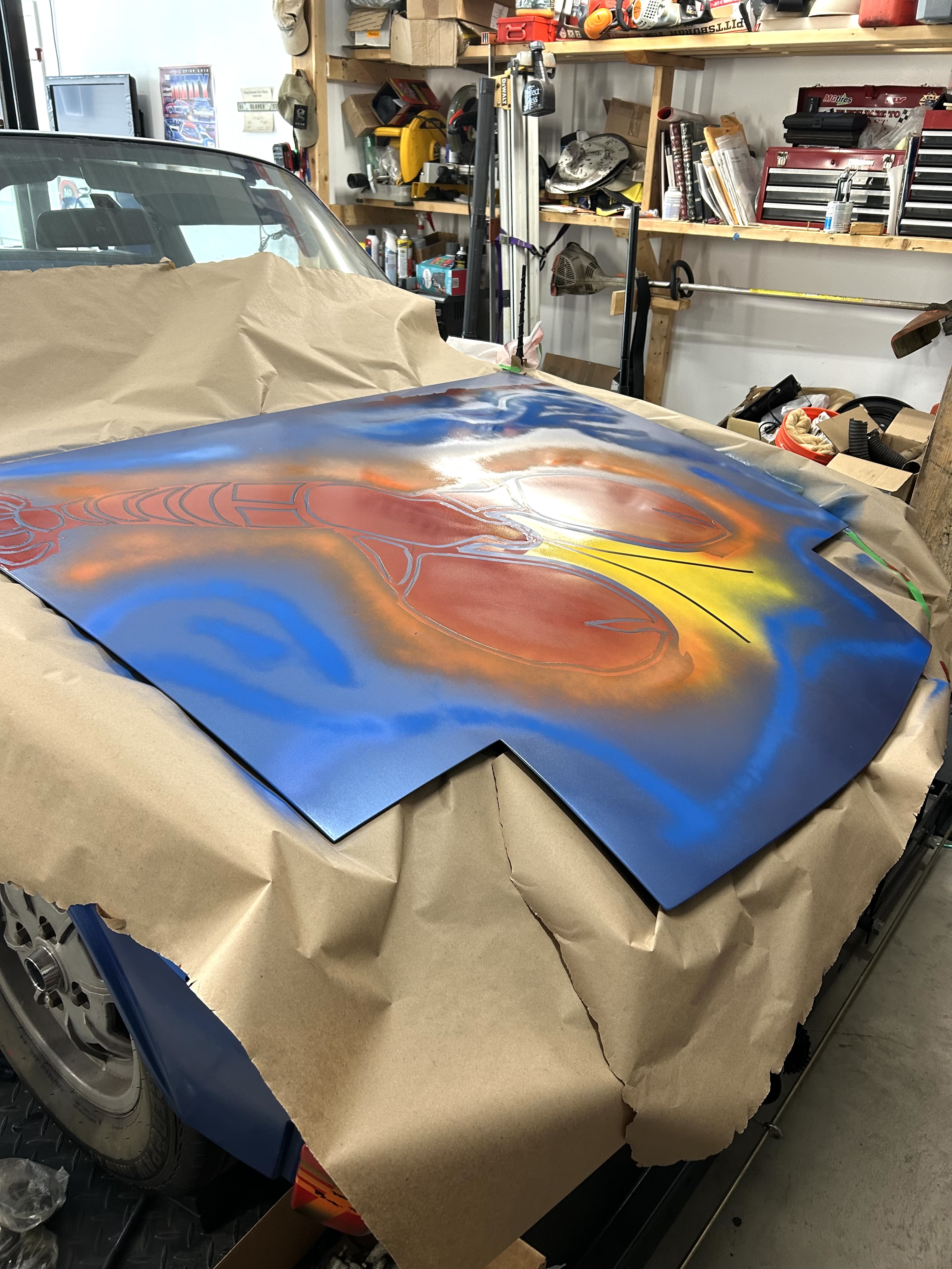

HFC3   The 914 had some blank canvas left to deal with. R...   Jun 28 2026, 04:06 PM
HFC3   Freehand on the Lobster.   Jun 28 2026, 04:09 PM
HFC3   He came out pretty good. Glare hurts the picture.   Jun 28 2026, 04:12 PM
East coaster   Rock Lobster!   Jun 29 2026, 04:32 AM
