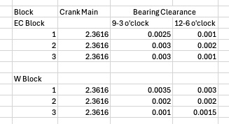

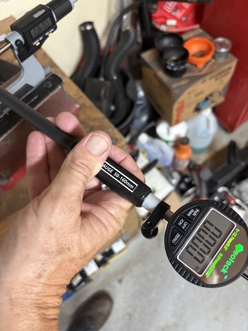

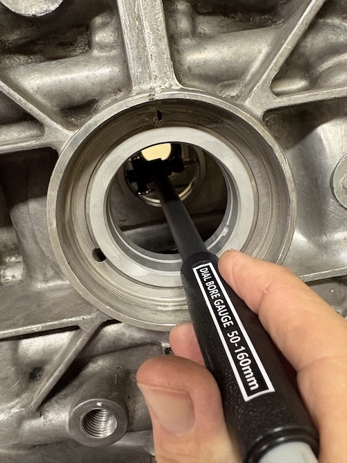

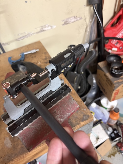

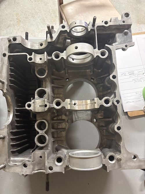

I spent a lot of time this weekend in the garage attempting to get good measurements on both my EC and W cases. While I measured the EC block's saddles a little tight, the W case measured a little loose from the .20 bore specs. However, once the .50/STD bearings were installed in the cases things changed a bit.
The saddle measurements where taken in relationship to a book value of 2.776 +/- .0004. I basically adjusted my 2-3" micrometer (zeroed with a 2" standard) to 2.776" and locked it in a vise. Next, I took my bore gauge and zeroed in the micrometer. From here, I measured roughly in the 9-3 o'clock and the 12-6 o'clock positions.

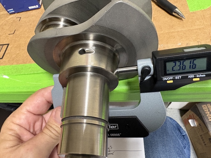

To determine the bearing clearance, I first measured the crank main journals with the digital 2-3" micrometer. From my measurements, all 3 main bearings were 2.3616". Locking in this value, I then clamped the micrometer in the vice and zeroed the bore gauge to this value. From here I measured several times in each of the clock positions on either side of the oil groove for each bearing. I did this multiple times throughout Saturday and Sunday to come up with a set of clearances for each of the first 3 mains on both blocks. These numbers represent the "tightest obtainable value" in and around the measurement areas using the bore gauge.
Not that these are set in stone. I want to continue working the instruments till I'm satisfied with all the numbers I'm getting. Repeatability is the word, I guess.

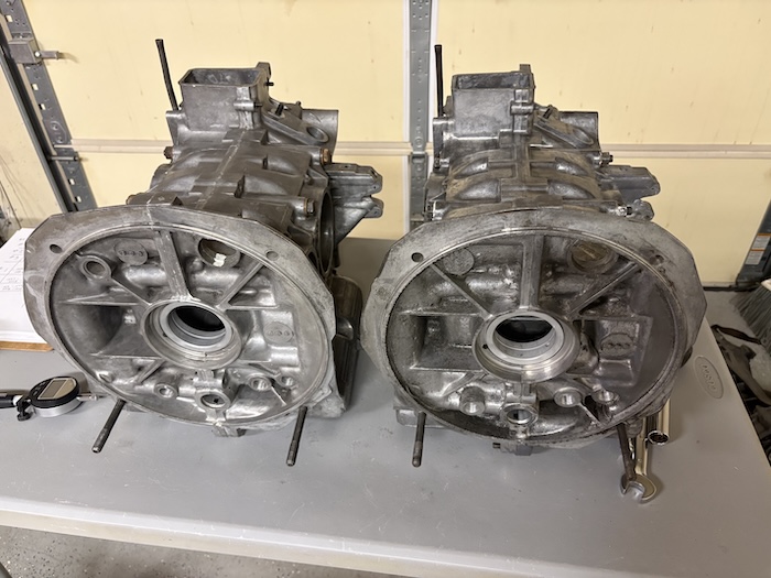

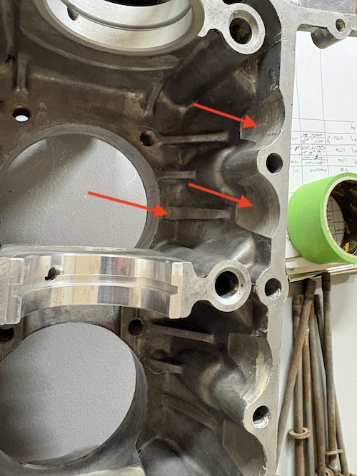

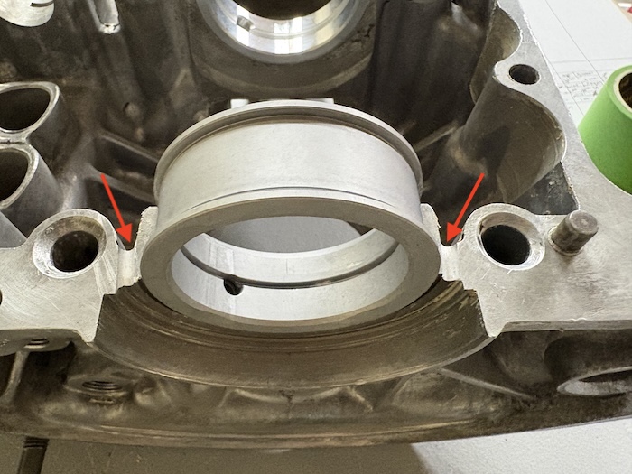

Including other photos I took while measuring the cases. Note the arrows showing the oil relief in the rear main of the EA Case as well as the "relief" areas that were required to handle the previously installed 82mm crank. We will be switching down to a more manageable 78mm unit with this build. (IMG:style_emoticons/default/smile.gif)
