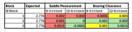

W Case Measurements:
Went out to the garage this morning, pulled the bearings, re-torqued the case, and took the following saddle measurements of the W case. FYI, this case was line-bored back in January of 2025 by EMW. Note: Anything in red is out of range, yellow is borderline, and green is within tolerance. Positive numbers are larger than mid-range spec. Negative are smaller than the mid-range spec.
So, if my measurements are accurate, I'm unwilling to use this block as-is. I'll do the same work-up on my EA case at lunch. Let me know what y'all think. TIA.
