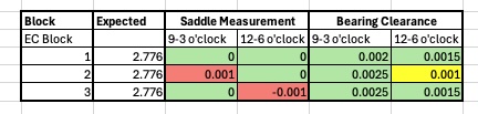

EA Case Measurements:
Ok, I might be alright. Here are the measurements for the EC case. The only adjustment I made was remeasuring my crank mains at 2.3617 instead of 2.3616. I felt I was a little "tight" on the journal when I took the original measurements.
AI says having a slightly tighter measurement at the 12 o'clock position (along the parting line) is fine.
