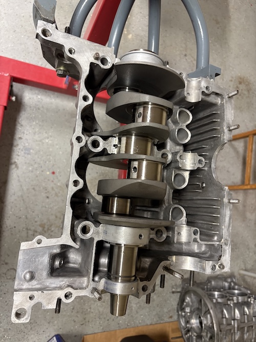

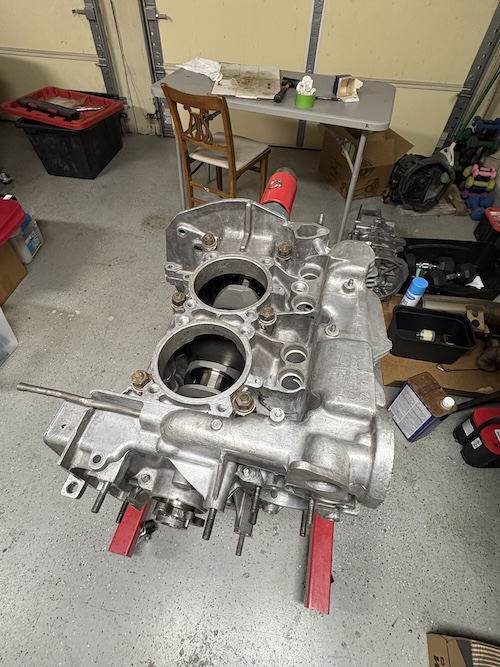

Initial Mockup
Used a light coating of assembly lub on the bearing surfaces and installed the crankshaft into the EC case. I checked for good rotation throughout the process. Installed the other case half, checked rotation, and then torqued the case in sequence. Final test was just the same. The crank moves freely 360 degrees by hand - no issues.
