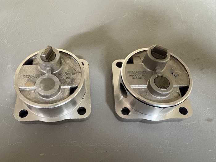

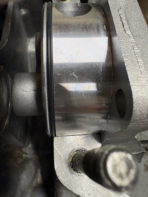

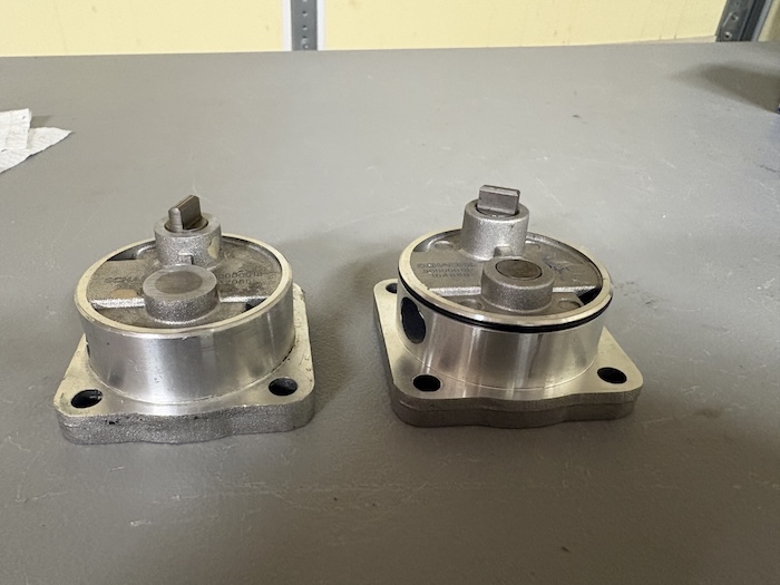

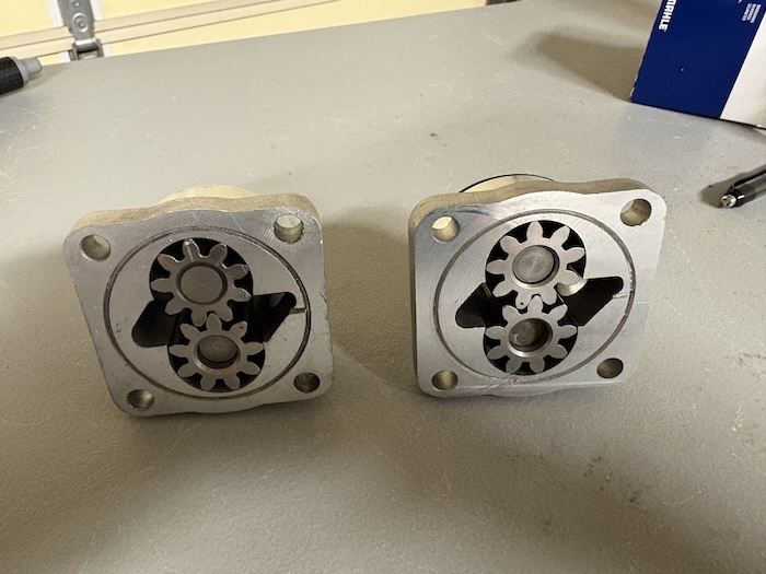

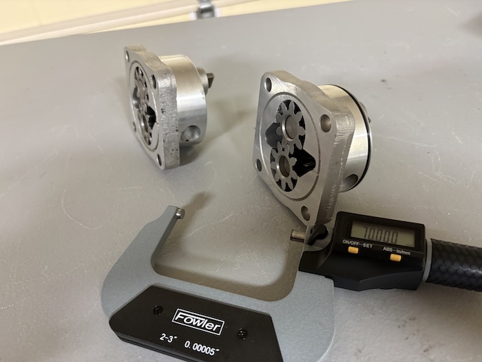

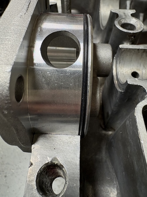

Oil Pump Checks:
Measured my Schadek 30mm pump that I had used on this engine previously. After measuring it, I can feel a little better that my low pressure problem might have source from this housing. I couldn't get any measurement to hit the 70mm mark. My new, o-ringed, 30mm Schadek pump does. When I set the micrometer to 70mm, I can get the it to pass over the first pump without much of a problem. Whereas, I can't do the same with the new pump.
If i go with the new pump I'm going to need to source at little bit of a stand-off or a thicker gasket to pull the o-ring back into the bore just a bit. This is obviously not an issue in the Type 1 cases. No decisions have been made on any pump yet. Still measuring...
