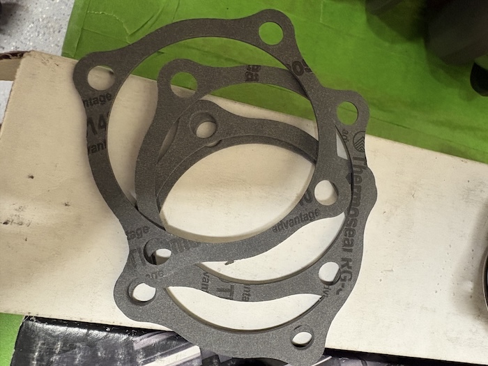

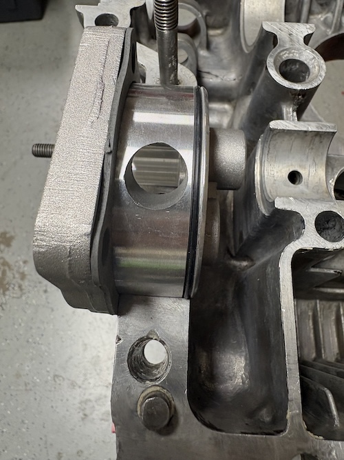

Oil Pump Checks (Part2):
Pulled out the pump gaskets for the LE's new pump. Nice and thick! Boy, that makes that o-ring sit a lot better - when crushed it might be ok. (IMG:style_emoticons/default/idea.gif)
