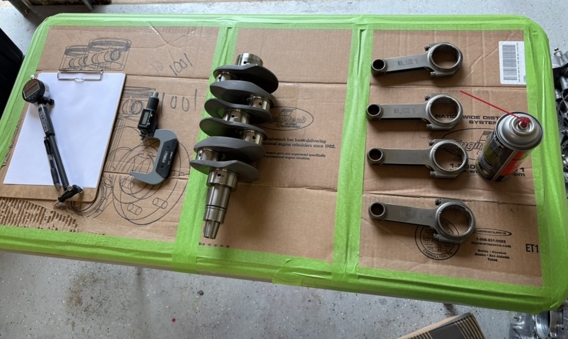

friethmiller   Initial Layout (6/27/2026): After about 5 hours o...   Jun 27 2026, 05:16 PM

Montreal914   WOW, super cool!! Where to begin my commen...   Jun 27 2026, 06:19 PM

Ninja   Ah, meat and potatoes... Thank you! So, 2258 ...   Jun 27 2026, 06:55 PM
friethmiller   Ah, meat and potatoes... Thank you! So, 2258...   Jun 27 2026, 07:16 PM
914werke   Rods checked out fine but were modified for bett...   Jun 27 2026, 07:43 PM

Montreal914   Good news! B:) Nice metrology tools btw. Di...   Jun 29 2026, 07:02 PM
