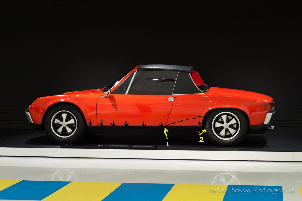

Is there a rubber washer ~4mm thick between the rocker and the fender? There should also be one in the front.
The rockers are very weak in that last rear ~foot as the lower reinforcement fold is notched away to clear the rear suspension. My view on this: (IMG:style_emoticons/default/rolleyes.gif) The rocker is riveted the whole length of the door sill, then is not supported for that last ~1ft and held at the back anchor point (black arrows in the picture). If the car flexes at the jack point (classic weak area), The fender will pull the rear anchor point up and will force the rocker to bend at the yellow arrow #1. This would induce a deformation on the rocker which, due to its natural bevel shape along the lower line of the car, would make the lower rear end to bend inward. Again... just a theory for what it is worth... (IMG:style_emoticons/default/laugh.gif) ![]() |
