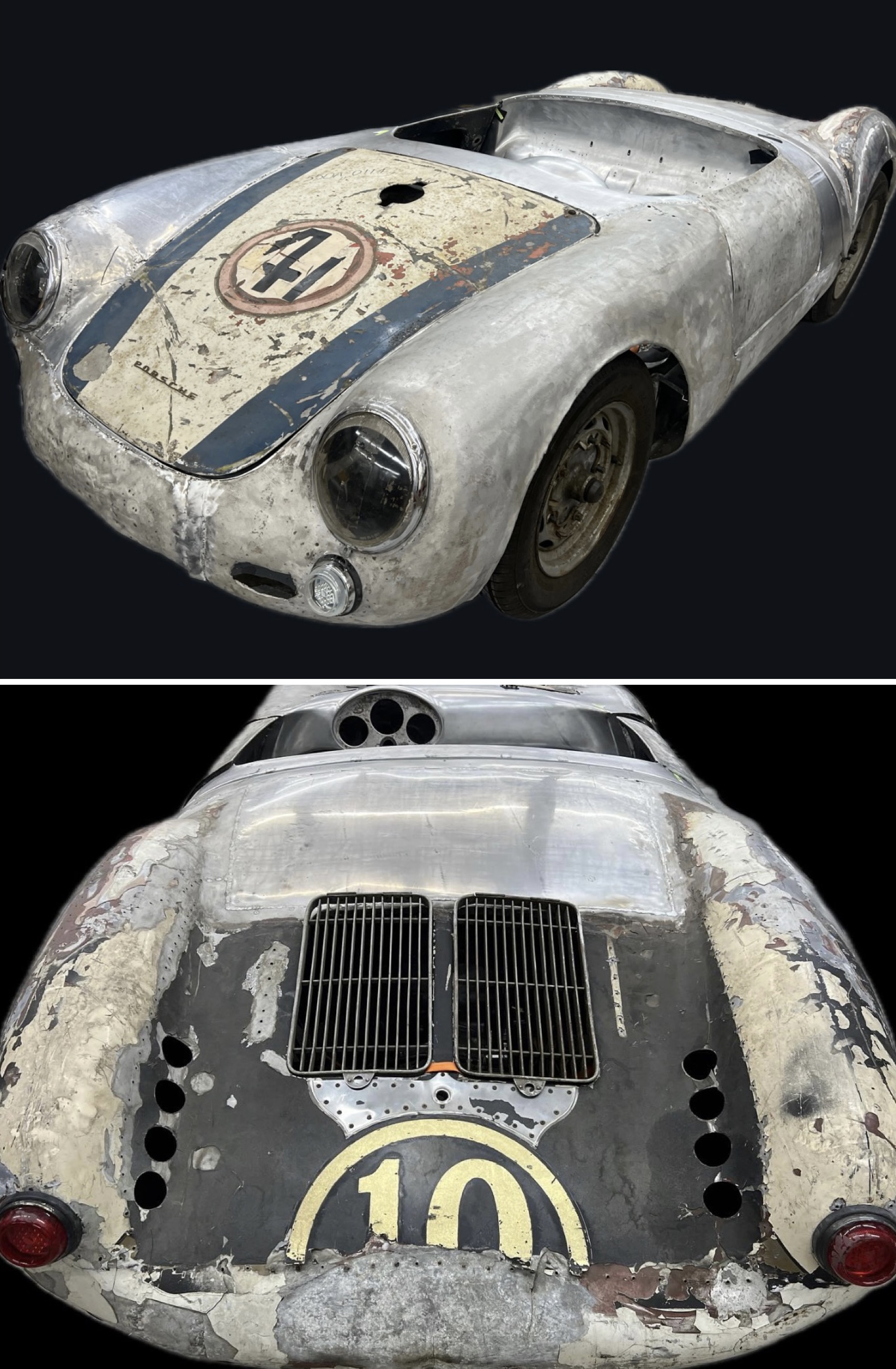

7 years to be able to sit and smile! Never give up, keep building, no matter how long it takes!!!

10 years of work and for the first time, it looks like a car. This car about broke me, way more complicated and unforgiving then a 356.

Superhawk996   Very cool. How much would you say is original vs ...   Aug 20 2023, 10:43 AM
Unobtanium-inc   Very cool. How much would you say is original vs...   Aug 20 2023, 10:47 AM

Superhawk996   That’s also a heck of an English Wheel collectio...   Aug 20 2023, 10:54 AM
DennisV   That’s also a heck of an English Wheel collecti...   Aug 20 2023, 10:57 AM
Unobtanium-inc   That’s also a heck of an English Wheel collect...   Aug 20 2023, 10:59 AM

Unobtanium-inc   It's all fitting together and with the floor i...   Aug 22 2023, 08:23 PM
Unobtanium-inc   Phase 1 is complete, only took 7 years! The b...   Aug 25 2023, 12:28 PM
KELTY360   Fascinating! Did any of those parts include a...   Aug 25 2023, 12:51 PM
Unobtanium-inc   The 356 front clip is the ID of the car.   Aug 25 2023, 02:00 PM
