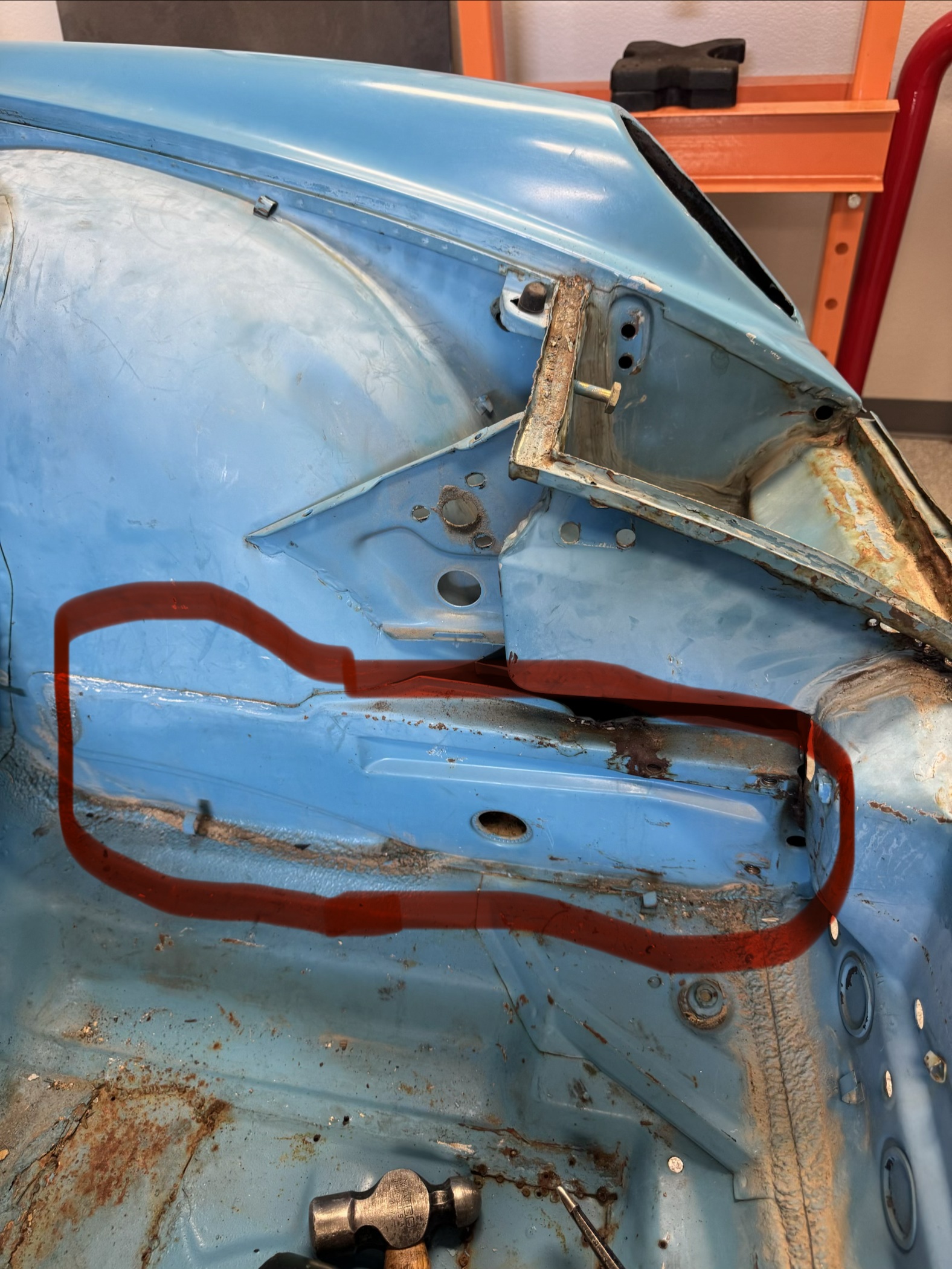

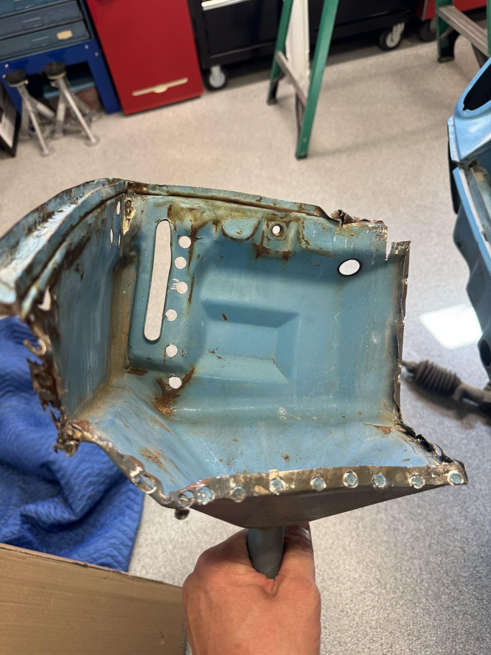

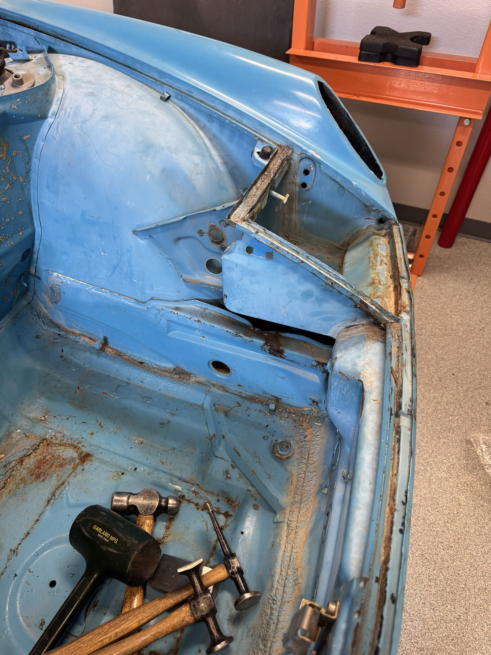

I was attempting to straighten out the front lip and noticed a lot of damage in the drivers headlight bucket area. The more I looked, the worse it got.
In short, I think the PO had a minor impact on the front bumper. It was hard enough that the impact shock kinked the support that is attached to the chassis on later cars.
As a result, the headlight bucket got pushed up. I'm guessing the PO then took a hammer and attempted to fix the front end as best they could, primarily to get the hood to close correctly. A couple hours with a spot weld drill and she's out:
I wanted to be able to get to that support piece and after really looking at the bucket I figured I needed to replace it. It was twisted up quite a bit.
I'll need to source a new headlight bucket and I have a couple leads.

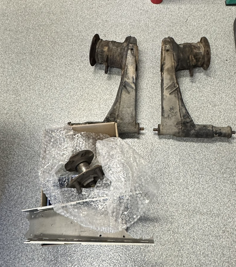

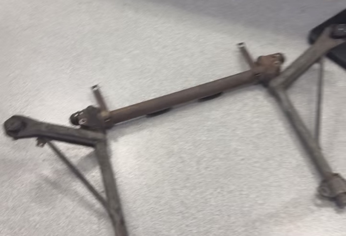

Both rear trailing arms are bent! Well this is what Patrick Motorsports told me.
I ended up taking my trailing arms there last week to get the full service of powdercoat, new bearings and bushings, adding the tow ring and boxing them.
My rep called me and informed me that both trailing arms are bent. I didn't ask how they verified this yet, but I'm guessing they have a jig that they use when they box the control arms and my arms probably were wonky when placed in the jig.
The rep did say they scored a bunch of 914 parts recently so they may have some good trailing arm cores. I was really hoping to save some of the cost with the core exchange, so this one hurts.
I don't doubt the PO was sliding around driving this car to the extreme, but after doing a search I didn't find much on bent 914 control arms. I read on another thread here you can put two 3' long bars through the holes and see if it's straight that way. I'd like to try that when I get my cores back.
PMS also said that someone had done some reinforcements or changes to the control arms previously.
I didn't notice anything but my reference photos before I dropped them off are lacking.
