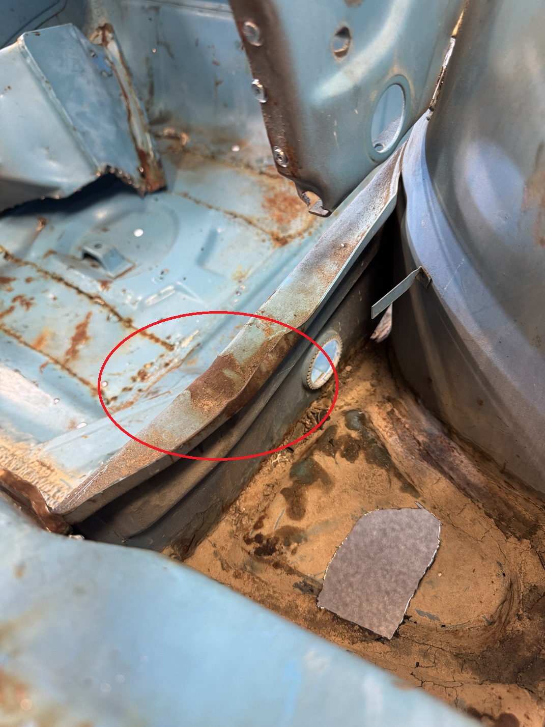

One thing that struck me about the 914 on that first visit, was that the car was extremely dry. Here's the ....ahem... heck hole.
Though the car was taken apart, the previous owner seemed to have all the original parts (though many of them were in his storage facility and not with the car.) Another cool factoid was that the car was actually purchased in a nearby Audi/VW dealership right here in Las Vegas. Vegas in '74 was very, very small, so to have a survivor 914 in the same town that it was 46 years ago is pretty cool in my opinion.
The car was more or less stripped in preparation for a GT conversion. I remarked in my mind about how solid the car was and went home that day thinking it was a good deal but that I'm a snobby 911 guy who doesn't buy anything but 911s :-P The car was definitely marinating in the back of my mind...

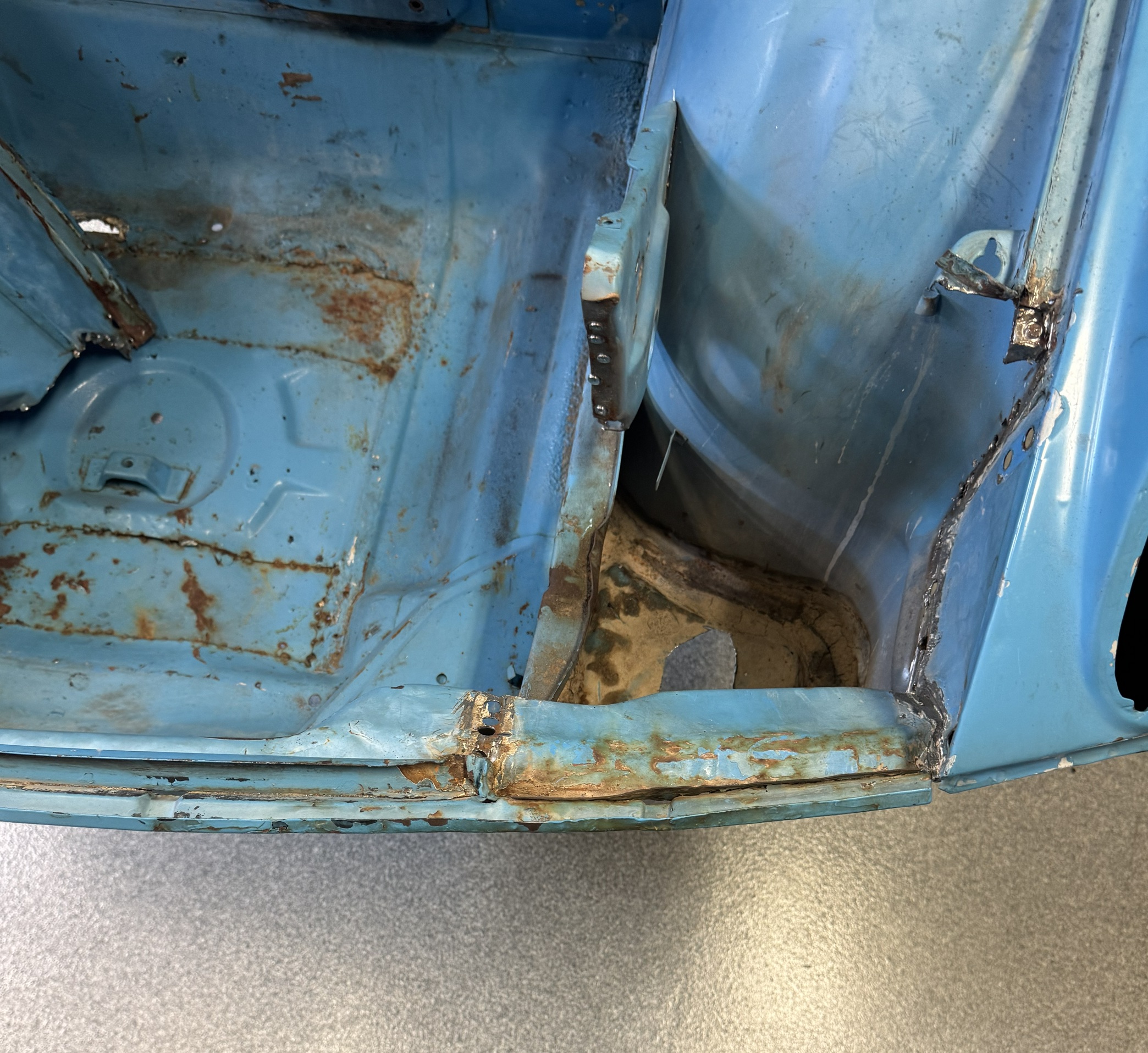

That's a good call. I imagine he would say just cut the RD part to fit. I can't imagine it's easier to cut the quarter around the bottom of the chassis.

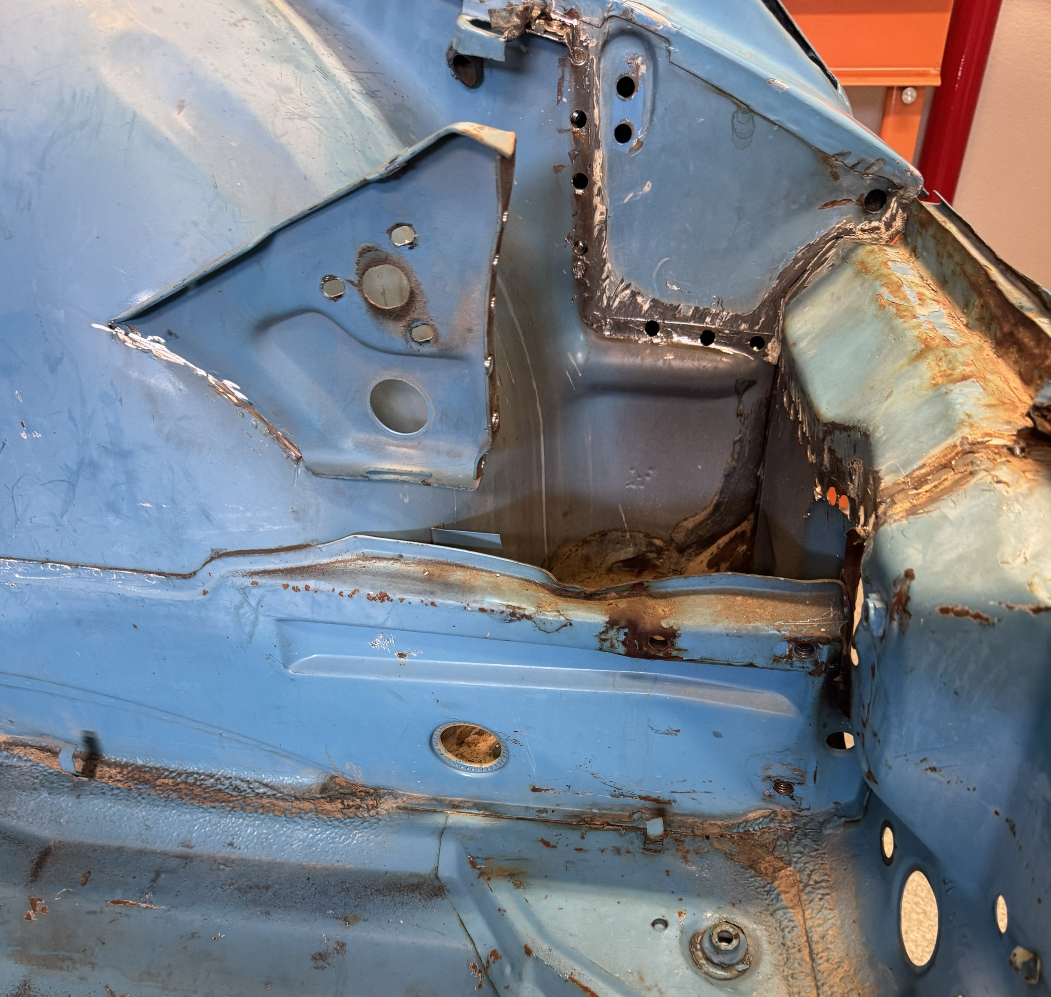

Here's some more photos of the headlight bucket area.
I took a long look this afternoon at the whole area. I wanted to see if maybe they had pulled that entire drivers front fender off at some point. I concluded that it looks factory which I think is a very good thing. I'm debating on whether I replace the whole front panel as it's kind of a mess and pushed up as it meets the drivers fender on the end.
This support piece needs to be worked on. Not sure if I should pull it and replace or attempt to straighten it.
