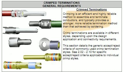

NARP74 Solder Aug 5 2026, 08:52 AM
914werke No. use crimps with the proper tool wherever possi... Aug 5 2026, 08:57 AM
Cairo94507 I have soldered wires and shrink-wrapped them. So... Aug 5 2026, 08:58 AM
Root_Werks I typically crimp, yes, use a correct crimping too... Aug 5 2026, 09:30 AM
GregAmy
I think they said it made the wire too brittle.
T... Aug 5 2026, 10:01 AM
Craigers17 While I always crimp my connections, I have to adm... Aug 5 2026, 01:31 PM
JeffBowlsby Good points made above. Copper wire work hardens ... Aug 5 2026, 01:47 PM![]() ![]() |
