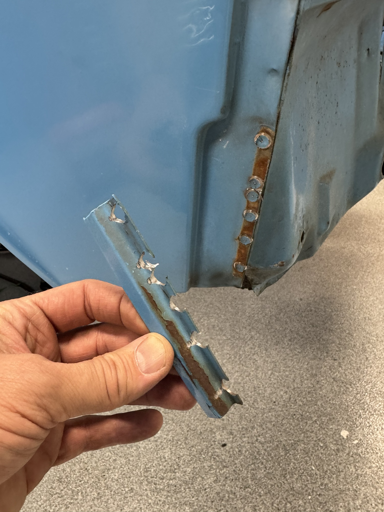

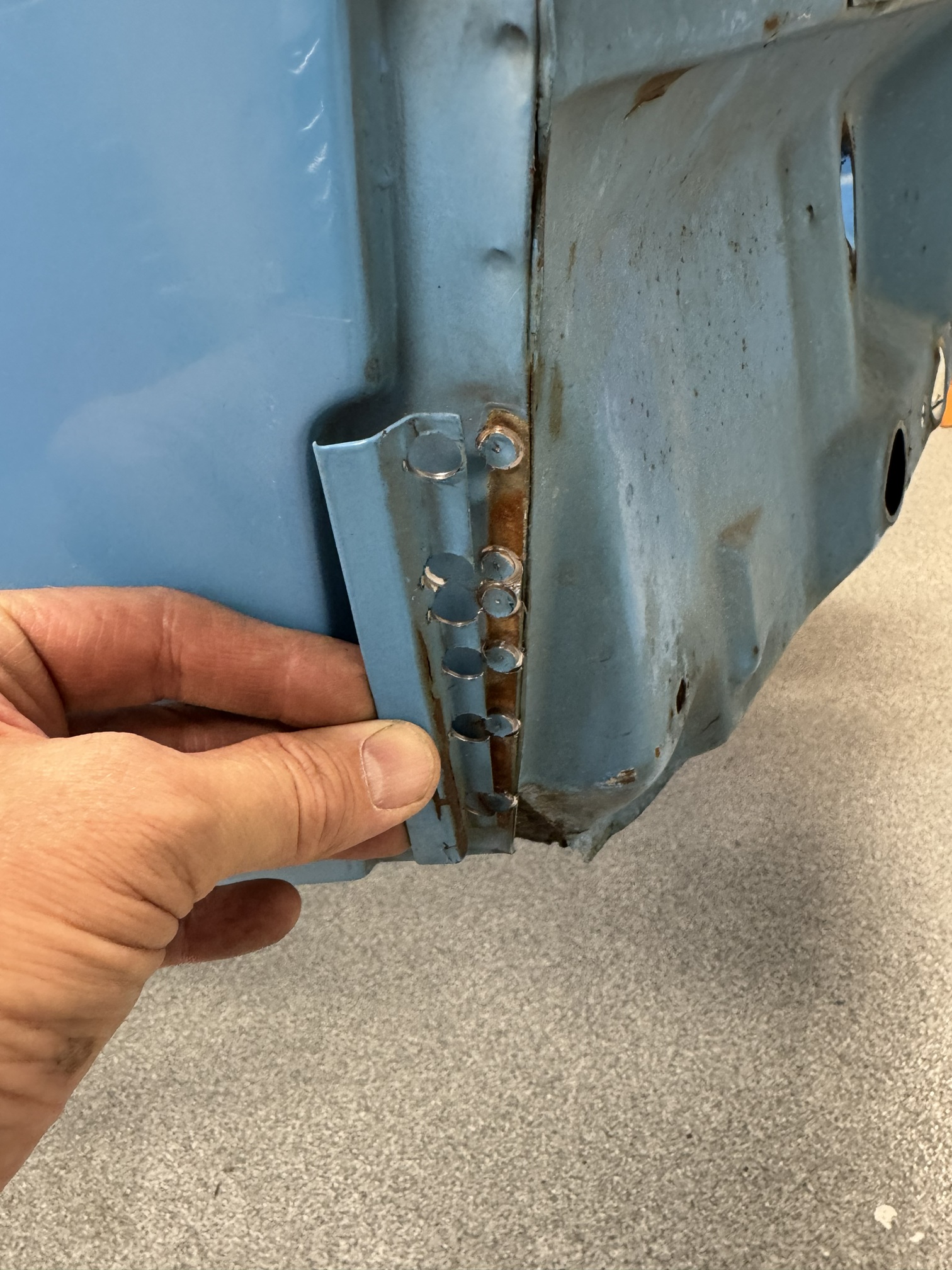

I checked in with Restoration Design on what to do with adding their long reinforcements, without cutting off the quarter, they said, cut the bottom loose and I should be albe to slide the piece up and under without removing the entire quarter.
I'll keep yall posted on whether that works and has enough flex without having to go up the side of the door jam as well.

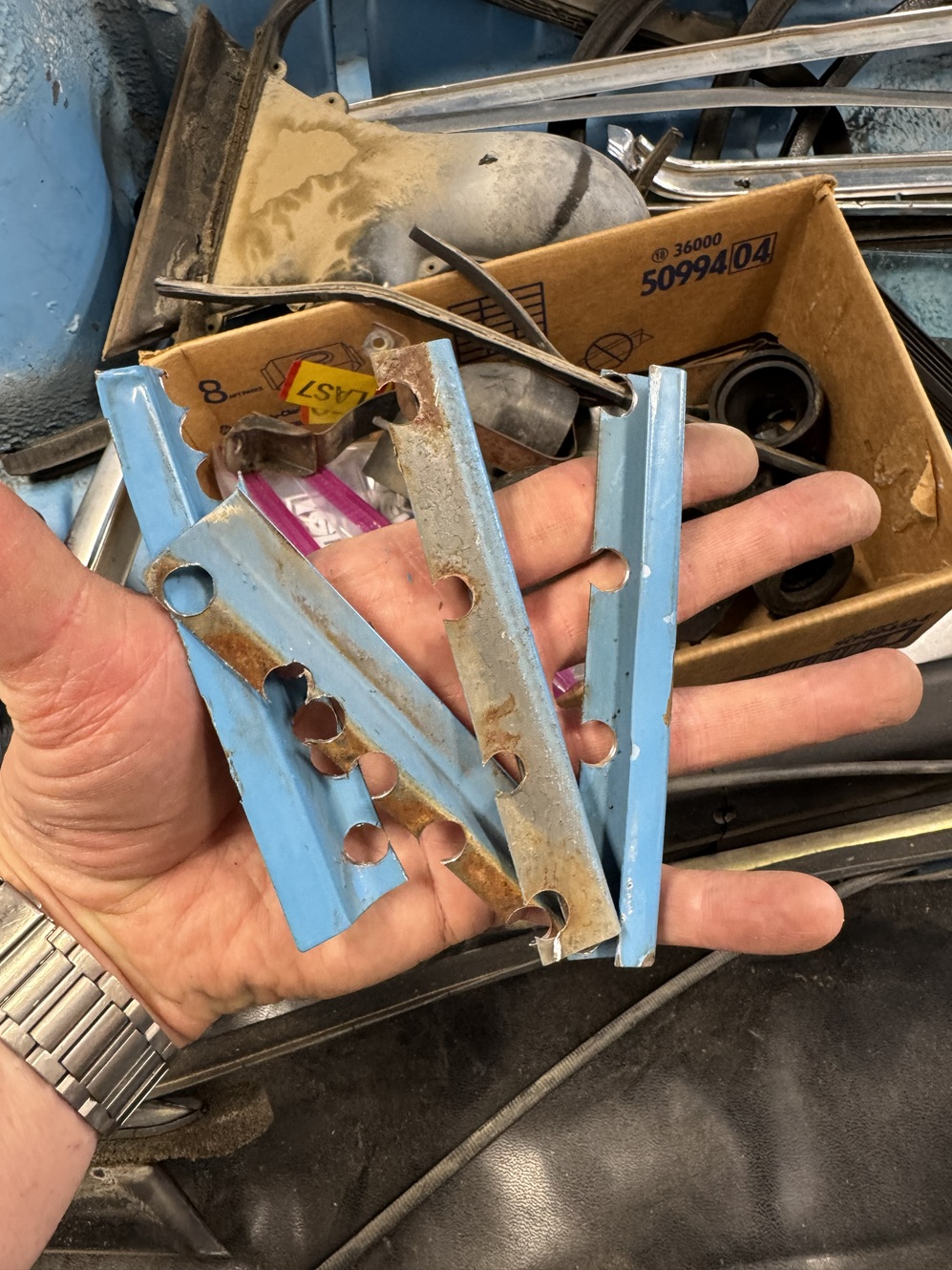

I did end up cutting off the rubber baby buggy bumper hooks. I used a spot weld cutter and it was pretty easy work.
I did a lot more measurements on the front end. It's not bad, I think I replace the kinked metal in the support panels and I ended up ordering a new 71-74 front piece. It solves a couple issues:
1. No need to cut off the rubber baby buggy bumper lip at the top of the 75 front end.
2. Covers all the impact shock holes for me.
3. Is a straight and new piece that will help me align the front end and the drivers headlight bucket.
For $300 I think it was a wise investment. They already shipped it too. They are a great business. It's really amazing that we have access to these new parts.

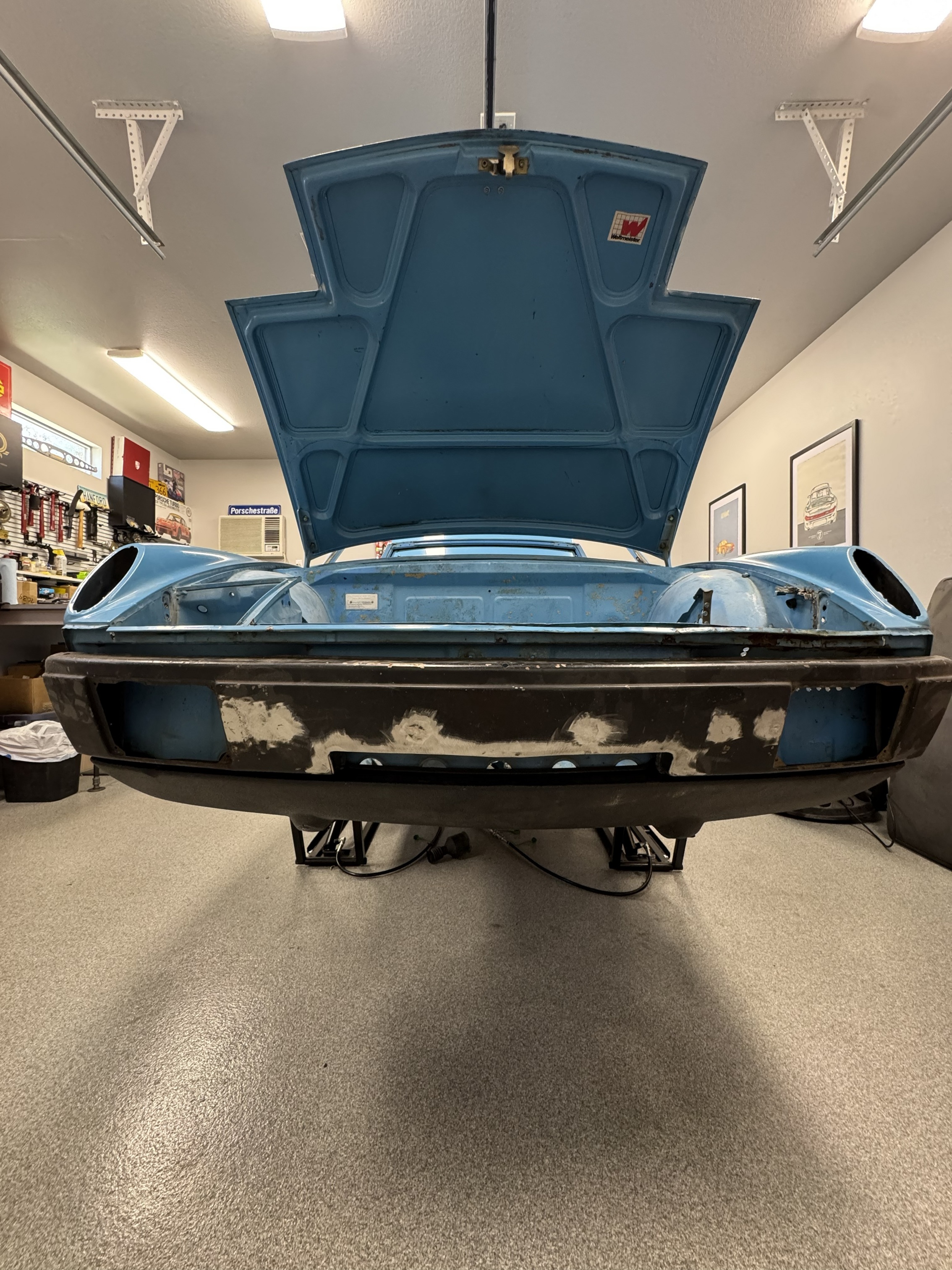

I did end up mounting my GT bumper and stock valance in order to get another idea of how badly the front end is bent. It's not bad, but the most concerning thing is the bumper fitment.
It barely slides over the fenders. I'm wondering if someone who has done a bumper backdate can speak to how much gap there is here when you did it?
