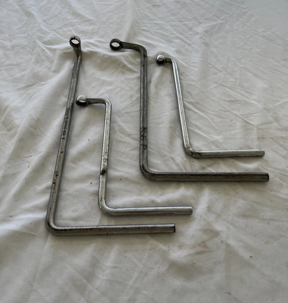

What have you found or fabricated to tighten the 13 ATF hex nut on 914-6 heat exchanger passenger side? I think that's cylinder number 1.
I'm sure this is probably mechanics 101, but I'm having a hard time with it. I've tried every combination of 1/4 socket, u-joint, wobble extender, flex driver I can find. No room for a box or open end wrench as 2 sides are blocked by bracket and pipe. Nothing I've tried provides enough engagement to properly tighten it.

Often called a distributor wrench

rudedude   SSI included either a 12mm or 13mm z shaped wrench...   Aug 20 2026, 09:23 AM
sixnotfour   best kept secret,, https://www.amazon.com/dp/B0BB8...   Aug 20 2026, 11:05 AM

Steve   I use a stubby 13mm wrench. I did see S wrenches ...   Aug 20 2026, 11:35 AM

fixer34   Want to say I used a ratcheting box end, swivel he...   Aug 20 2026, 05:38 PM
