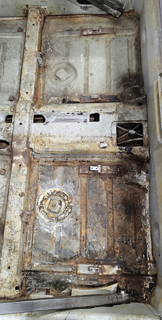

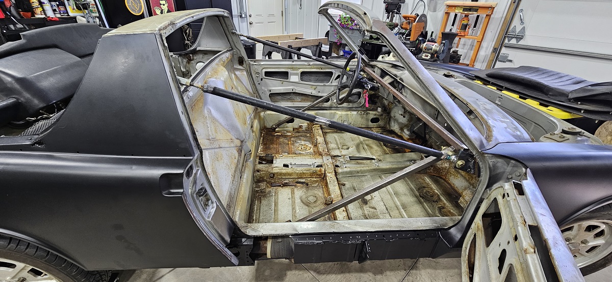

Got the door braces made up and installed. Started removing the tar paper from the floor pan. We got the drivers side rear section done and called it a day. Once the tar paper is off it goes on the rotisserie.

MikeK   I like how you braced the door openings so that yo...   Sep 3 2026, 09:12 AM
Luke M   I like how you braced the door openings so that y...   Sep 3 2026, 03:12 PM

MikeK   Thanks for detailed photos of the door struts. It...   Sep 12 2026, 11:11 AM
Luke M   No Problem Mike. This setup seams to work well. I ...   Sep 12 2026, 01:29 PM

Graydingo   nice work! yeah the brace system is ingenious.   Sep 18 2026, 04:22 PM
Luke M   nice work! yeah the brace system is ingenious...   Sep 19 2026, 06:21 AM
