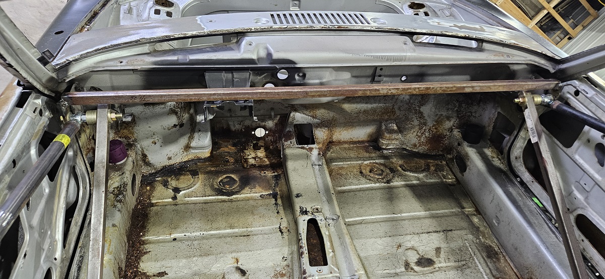

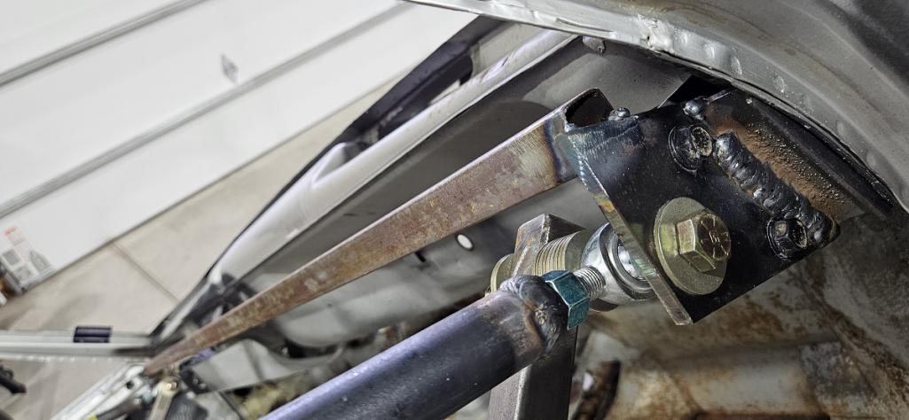

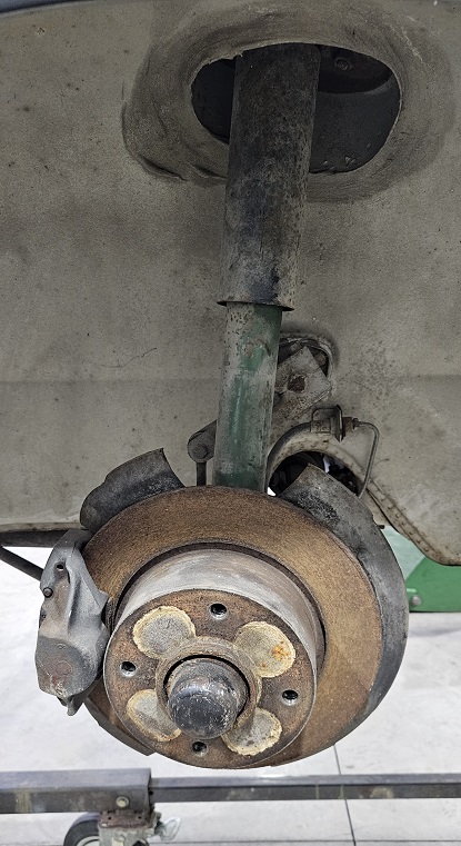

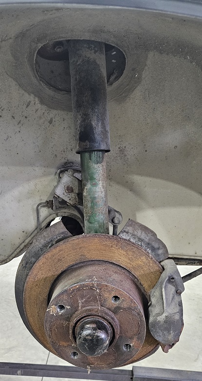

The 73 is on the rotisserie. We got the rear control arms and shocks off. Thursday we will take the front end off. Looks like Bilstein struts are installed. These will be going up for sale here soon.

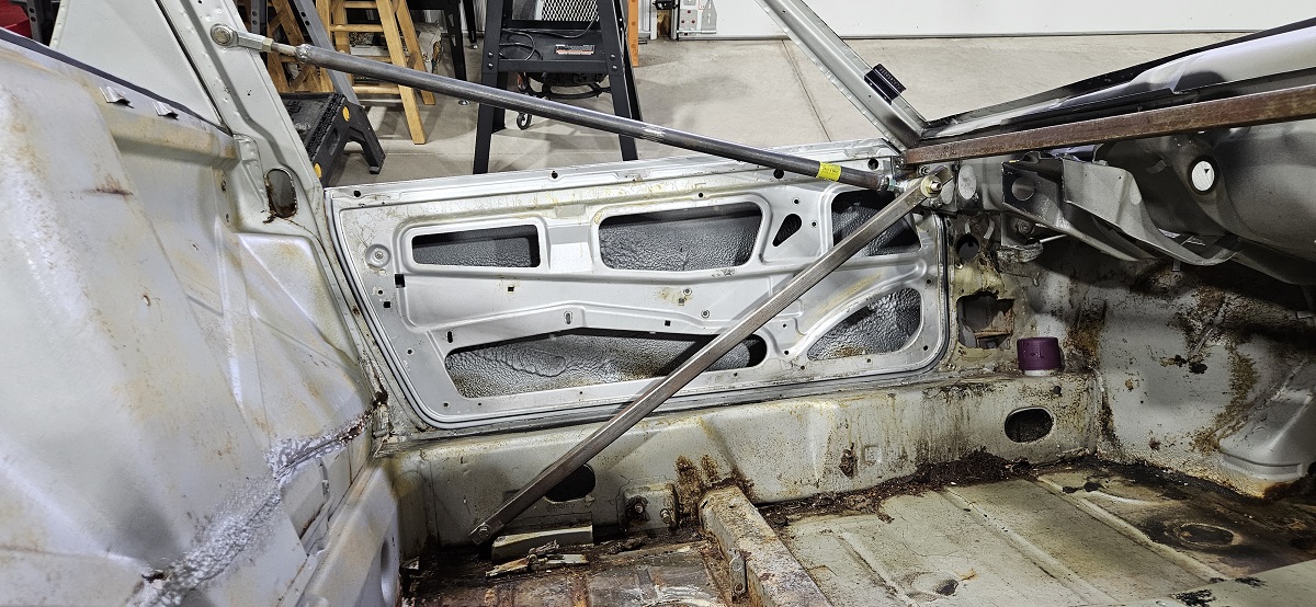

I like how you braced the door openings so that you can trial fit the doors.
Can you post some more details and pics of what you did?
Thanks!

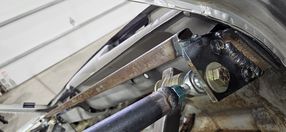

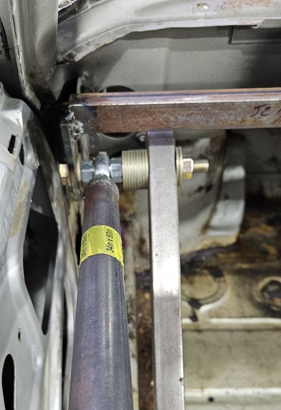

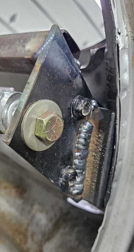

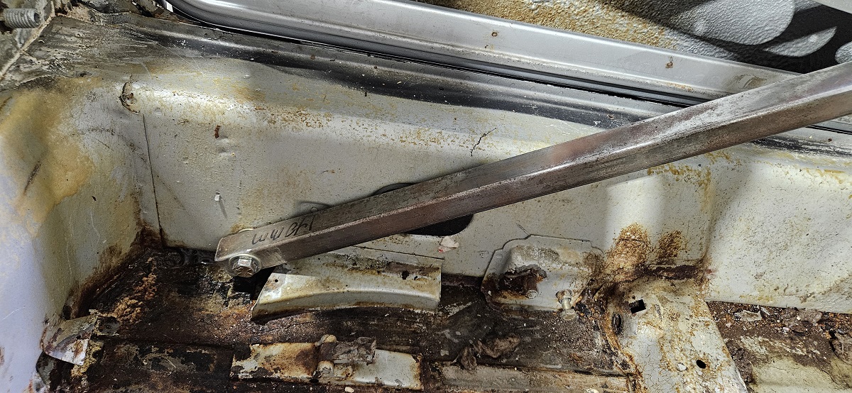

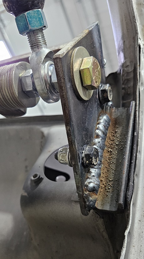

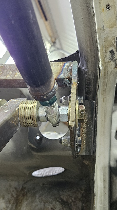

QUOTE(MikeK @ Sep 3 2026, 08:12 AM) *
Thanks!
This setup works really well and yes you can open and close the doors. I like this setup especially when doing door post installs. Makes it very easy to test door gaps too. The upper braces have left hand and right hand heim rod joints. The lowers are just square tube drilled to fit at the mounting points. I think that I'll add a few extra braces from the cross tube to the chassis. It may not need it but I don't think it'll hurt. I'll get you better pictures and info on Friday.

Luke M   Got the door braces made up and installed. Started...   Aug 27 2026, 03:02 PM

MikeK   Thanks for detailed photos of the door struts. It...   Sep 12 2026, 11:11 AM
Luke M   No Problem Mike. This setup seams to work well. I ...   Sep 12 2026, 01:29 PM

Graydingo   nice work! yeah the brace system is ingenious.   Sep 18 2026, 04:22 PM
Luke M   nice work! yeah the brace system is ingenious...   Sep 19 2026, 06:21 AM
