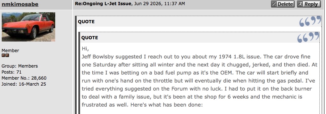

My 1974 1.8 with fuel injection will only start by manually opening the throttle but I can't get it idle and thus run properly. I recently had the AFM rebuilt and replaced the points, plugs, condenser and replaced the CHT sensor but the problem continues as it did before. I've looked for vacuum leaks to no avail with starter fluid. I now seek the expertise of the members of this forum for additional suggestions.
