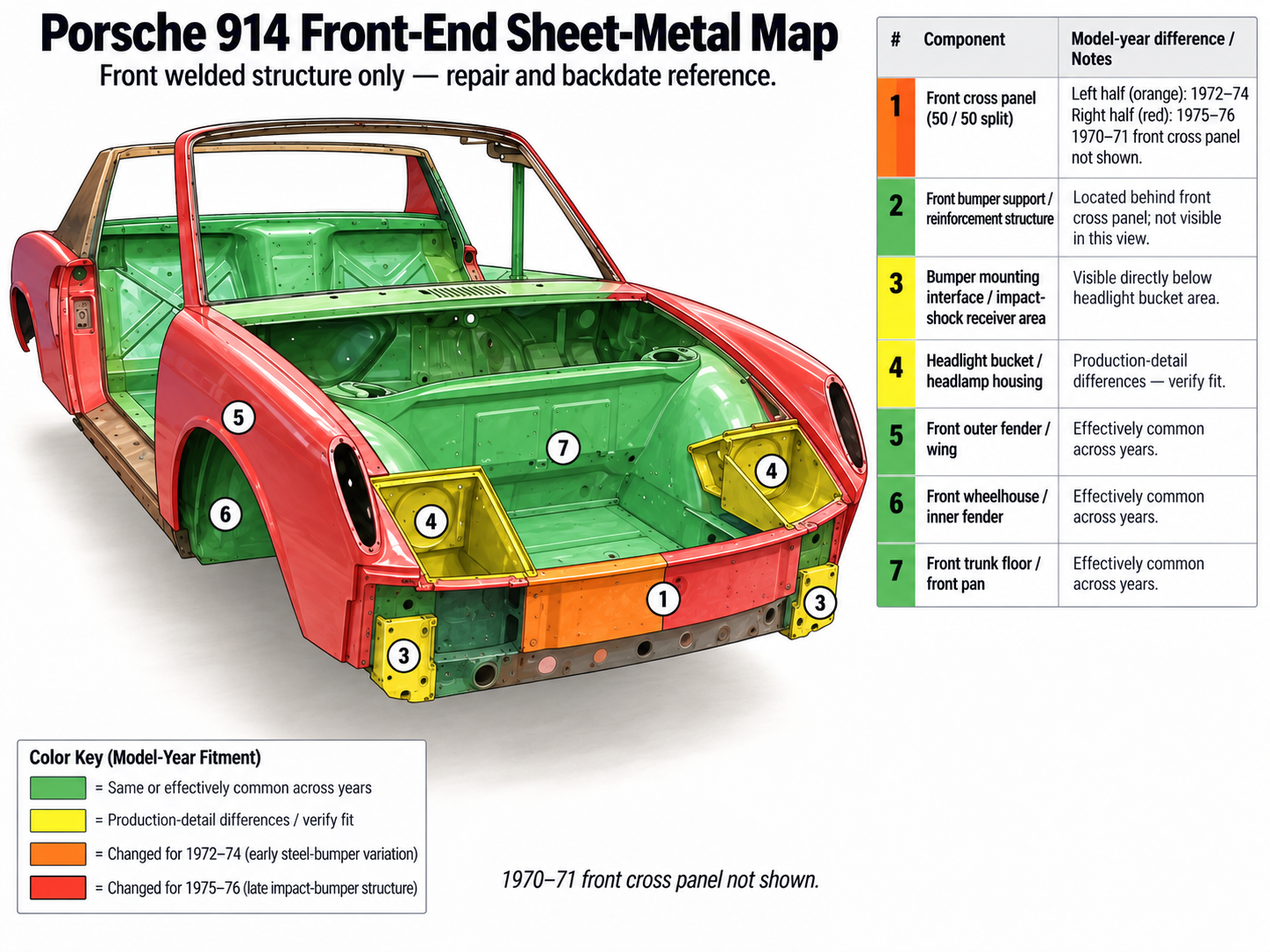

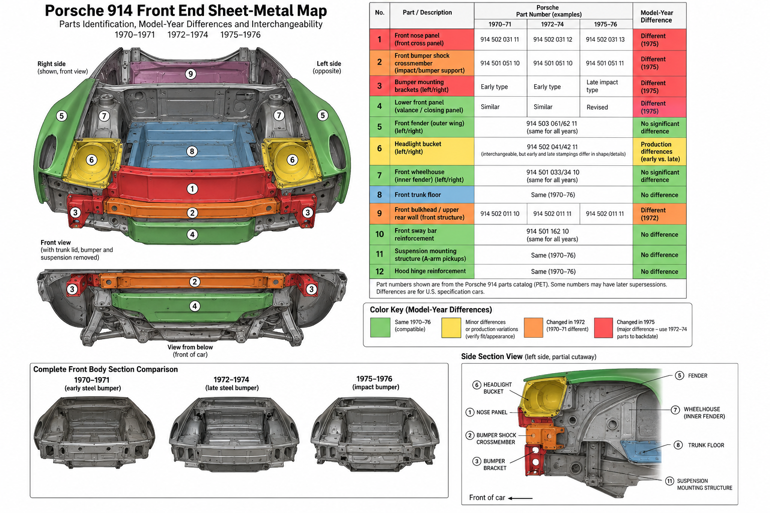

-Did a few test fits of the restoration design nose panel. I chose the 71-74 panel to make backdating the bumper easier and to replace the damaged 75 panel that was crunched on the drivers side.
- played around in chatGPT to try to make a graphic that explained differences in the front sheet metal by year to maybe help someone in the future.
Please excuse the AI slop, i played with it for an hour and it refused to follow my instructions, but I think i can make a better one using a different graphic program. Chatgpt is horrible for making images. I probably need a plugin or something.
so please excuse the myriad errors visually and probably otherwise.
This is my 10th revision, but still goofy in a lot of ways:
The fenders should be green, but since the reference photo was red, the AI blew a circuit. Anytime I tried to correct it it came up with more goofy iterations like making the headlight buckets round, or mixing the turns with headlights or just adding random car parts lol.
