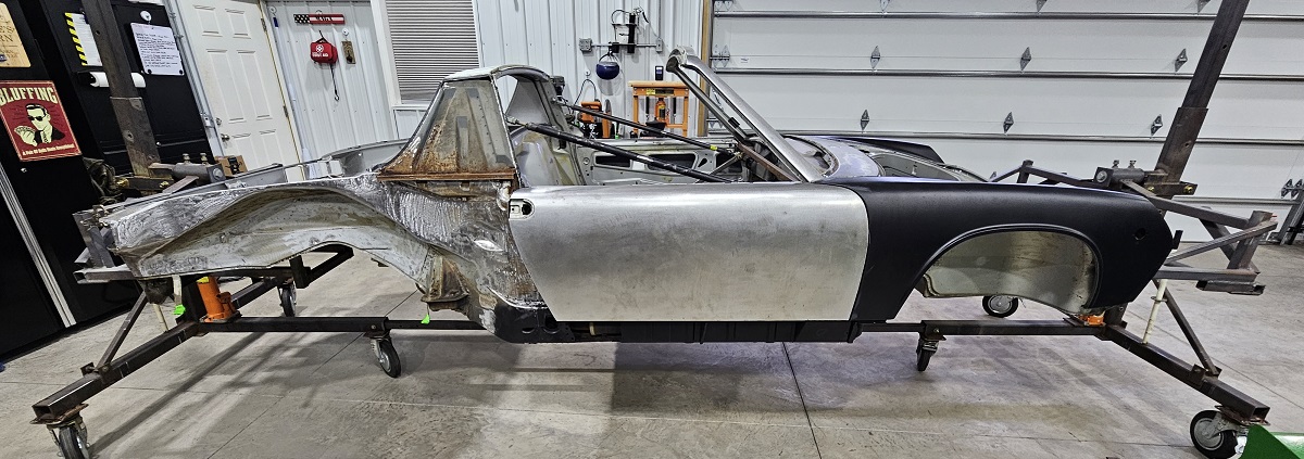

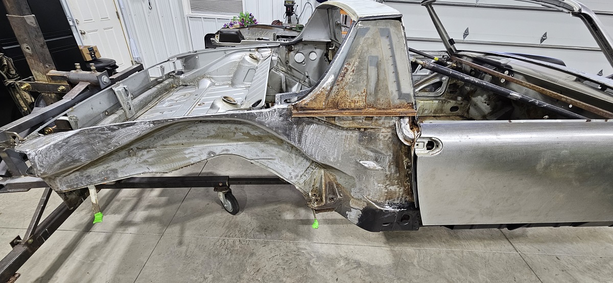

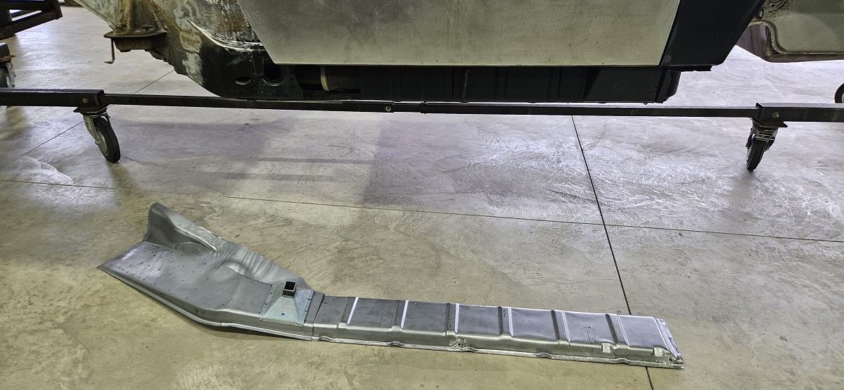

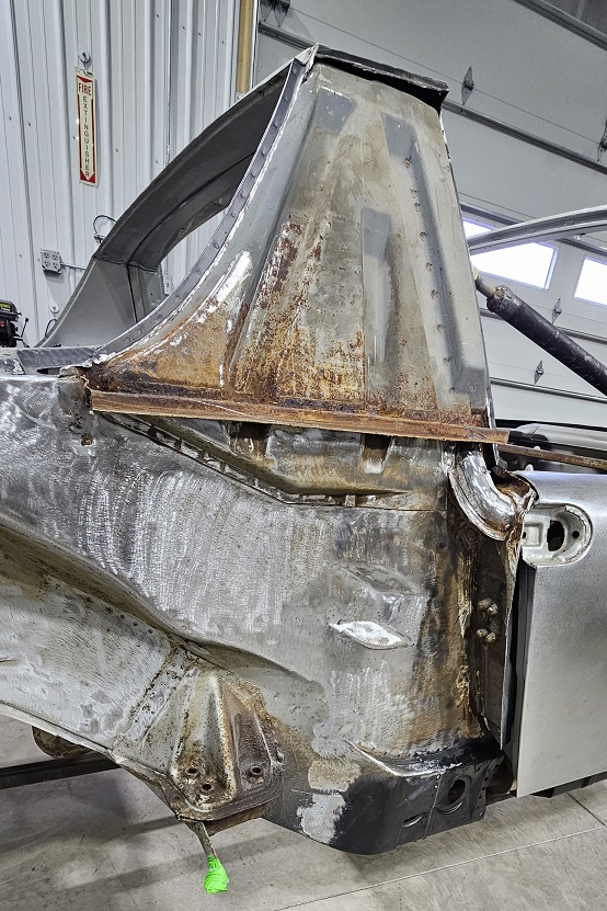

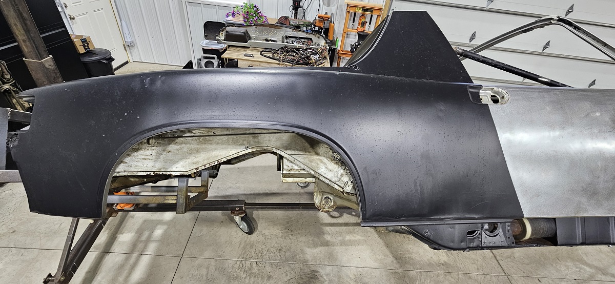

I spent a little time yesterday looking over the right side long and rear q-panel so I could come up with a repair plan. Looking at this r/r q-panel I figured it would be best to remove and replace it. It has dents and rusted out sections in several spots. Someone also drilled a few holes through a dent and slapped some bondo on it. I figured no big deal I have a r/r q-panel that's in great shape on hand. It would also save me hours of cutting and welding in new metal to repair it. It also gives me a chance to take a better look at the inner fender by the hell hole and take care of any possible issues. I got the spot weld drill bit/tools out and off she came. I found a few minor issues but otherwise pretty solid. It's now time to deal with the right inner rocker and jack point repairs.
