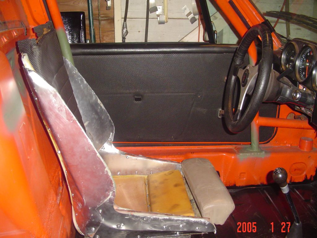

I stopped working on these seats until just recently, Thought I'd take a different approach. This time I decided to try my hand with aluminum. I've used pop rivets, fiberglass and epoxy glue. They are really strong, doesn't flex anymore than the original fiberglass so I think they'll hold up.
Doug C

DougC   I stopped working on these seats until just recent...   Feb 15 2005, 11:27 AM
trekkor   Yes, that looks like it would be strong. Post prog...   Feb 15 2005, 03:15 PM
cha914   Looks good.... one thing to consider though with ...   Feb 15 2005, 04:33 PM
