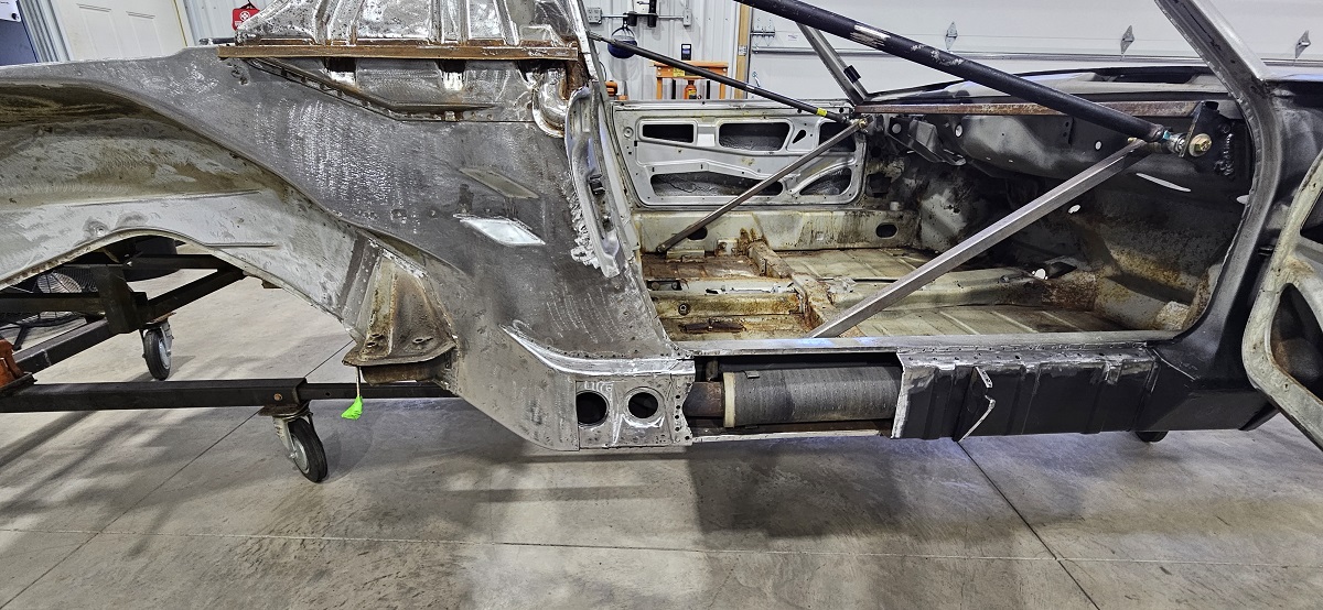

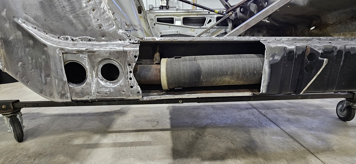

Luke M   I spent a little time yesterday looking over the r...   Sep 10 2026, 05:02 AM
Luke M   Prepping the right long for repair. :sawzall: :s...   Sep 11 2026, 10:21 AM
