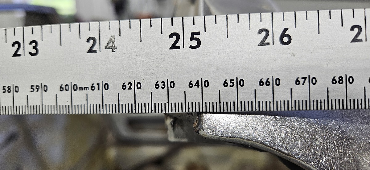

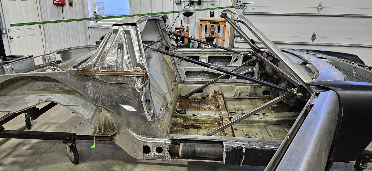

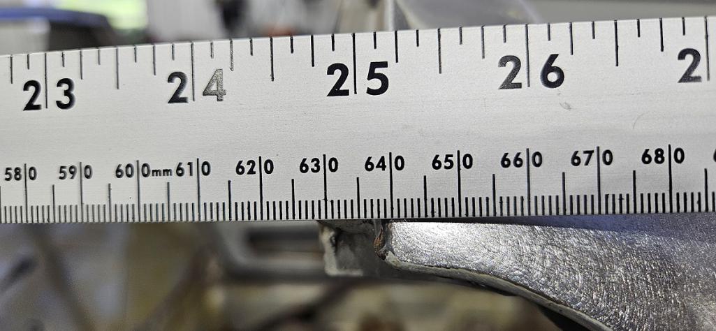

MikeK   Thanks for detailed photos of the door struts. It...   Sep 12 2026, 11:11 AM
Luke M   No Problem Mike. This setup seams to work well. I ...   Sep 12 2026, 01:29 PM
