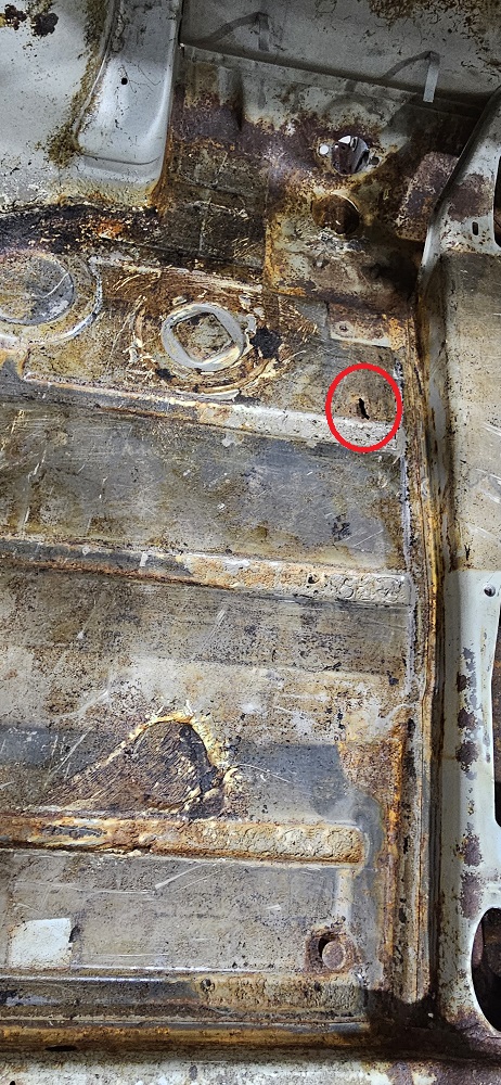

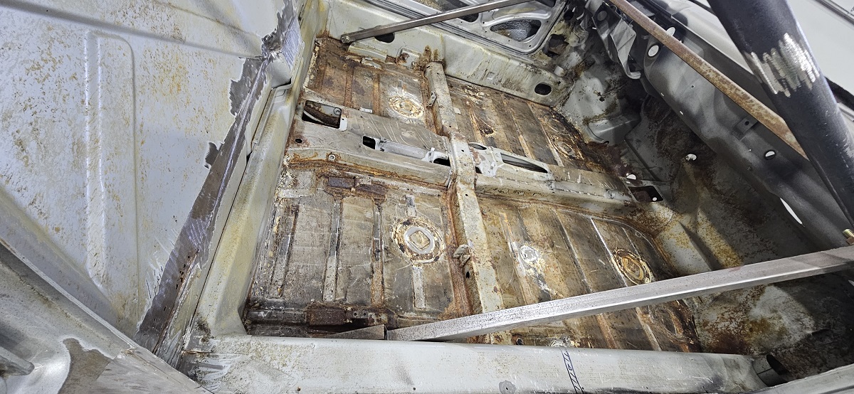

Got a few things done and off the to do list. All of the tar paper is removed from the floor pan. We found one small issue with the floor pan. There's a small rust hole by the throttle pedal mount. I need to remove the pedal support bracket then fix the rust hole.

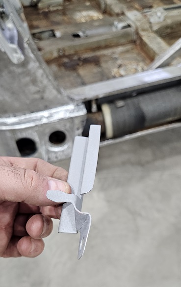

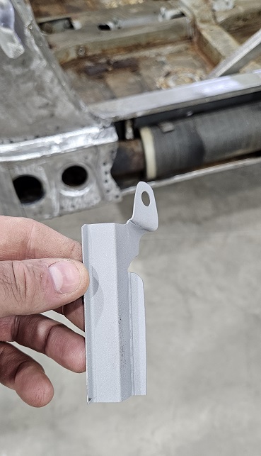

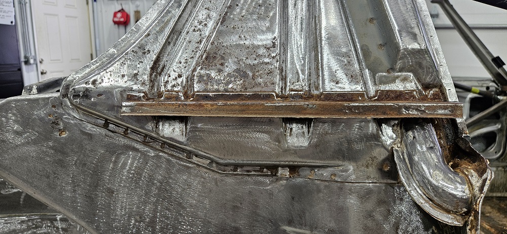

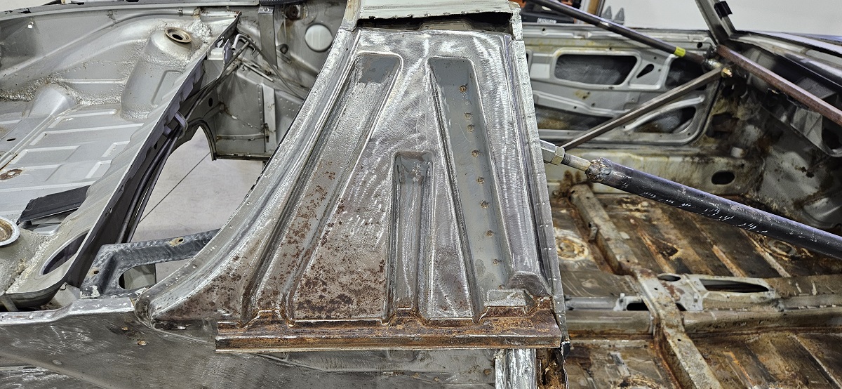

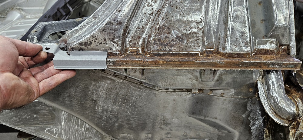

I have a new bracket among other things on order. Moved to the firewall where I found a few spots that will need to be repaired. Gotta love the firewall engine pad that collects and holds water like a sponge. Started fixing the right targa inner support bracket flange. I made a custom piece to fit and only took about 2 hours.. (IMG:style_emoticons/default/blink.gif) Cut, grind, test fit... repeat.....
Here's a piece of knowledge for you guys and gals.. If you ever have to replace this on a future project use an piece of an old door sill. Works like a charm and has most of the bends already there for you. The more you know... (IMG:style_emoticons/default/beerchug.gif)
