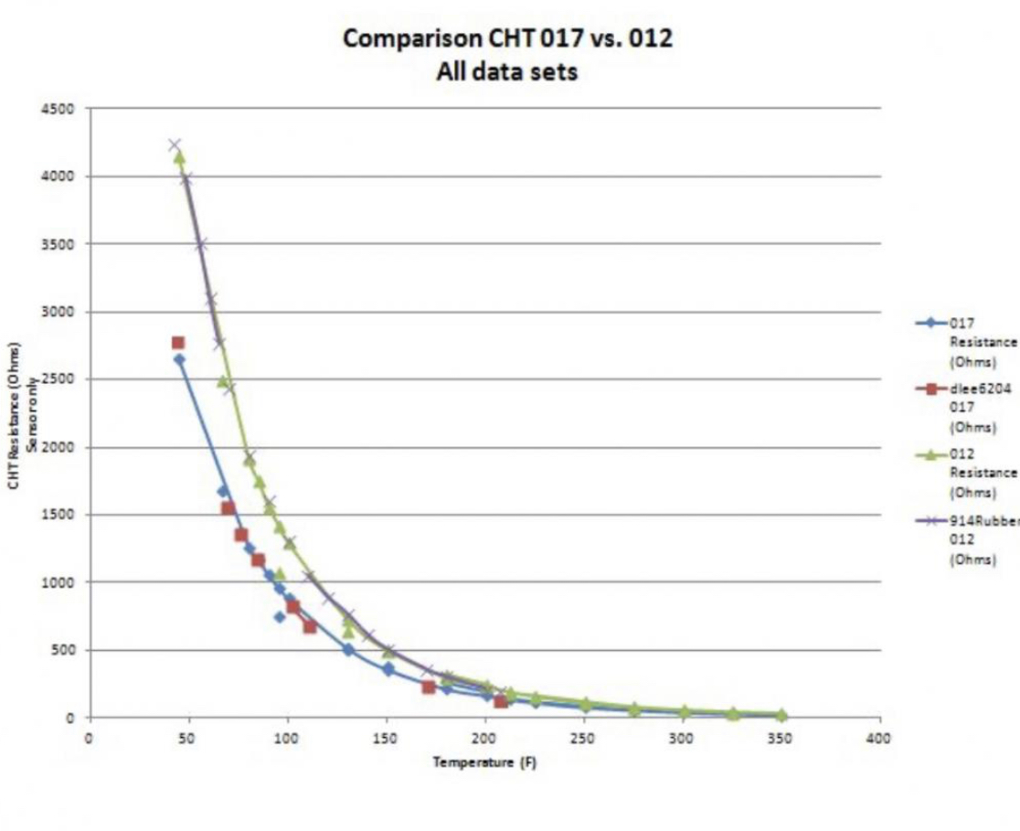

Here is the curve for CHT sensor - you will have an 012 CHT sensor.
Check both hot and cold Attached Image
