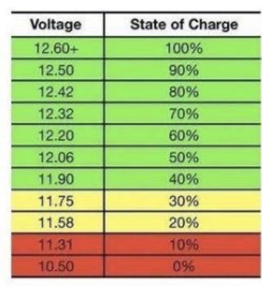

While doing this I was checking voltage form the ignition wire terminal on the solenoid to negative on battery.
it is down to about volts when trying to start.
so would you say this is confirmation of ignition switch or need for the additional solenoid or might the battery be weak?
Superhawk996
post Sep 28 2026, 05:55 PM
Posts: 8,147
Joined: 25-August 18
From: Woods of N. Idaho
Member No.: 22,428
60% SOC isn’t great
The fact that it drops to 9.1v when cranking is basically telling you the battery is on its last leg.
If this is the best it gets after charging the battery it’s toast.
