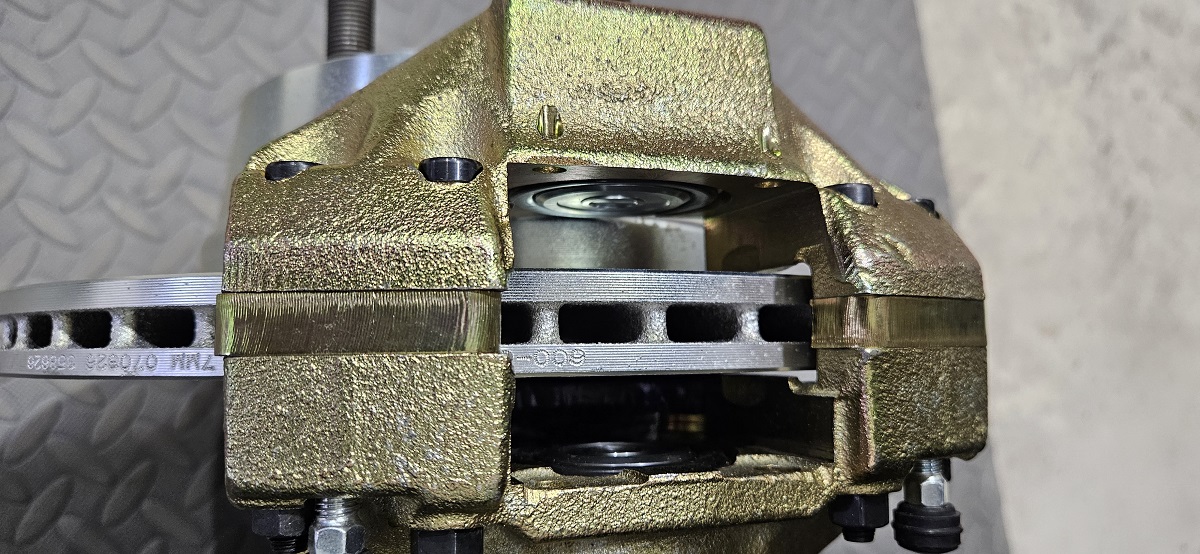

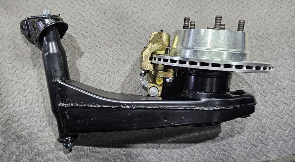

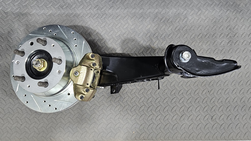

I did however get some new parts in and got one rear control arm assembled today.
Moving slow so it took all darn day to do just one side.

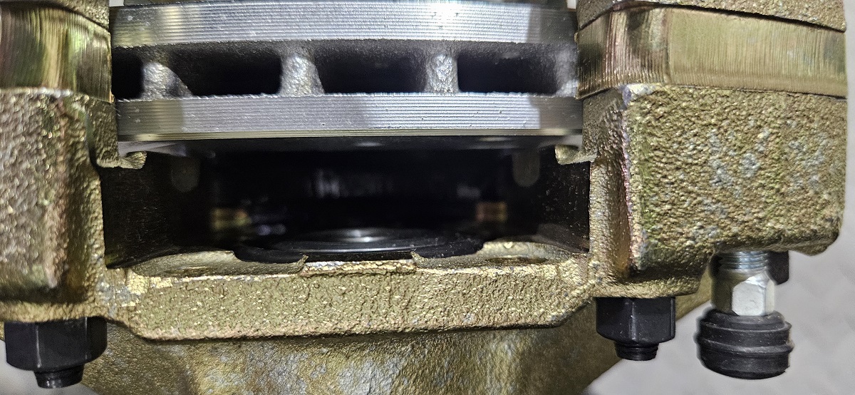

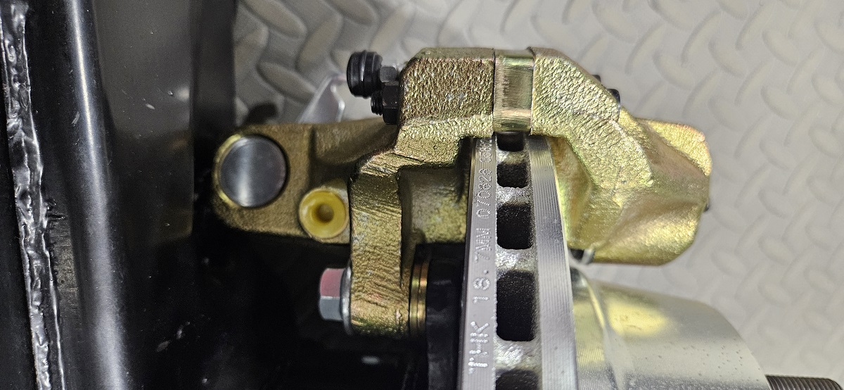

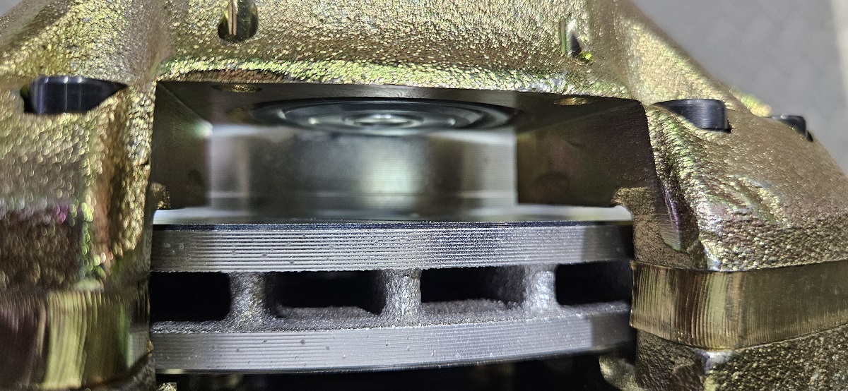

I'm using factory 6 rear hubs, stubs, German made bearings, PMB 6 GT calipers, pads, hardware, and new 914rubber bushings with some re-plated shafts.
I need to get a hold of Eric at PMB about the spacer situation that I got going on here with the calipers. Looks like I need a 5 mm spacer to have the caliper centered over the rotor. I have two washers stacked right now at 4.5 mm. I'll see what Mr. Eric has for a fix. I know PMB sells the GT rotors but I already had these SC rotors on hand.

Luke M   I got the rear caliper spacing figured out. I miss...   Oct 22 2026, 12:18 PM
