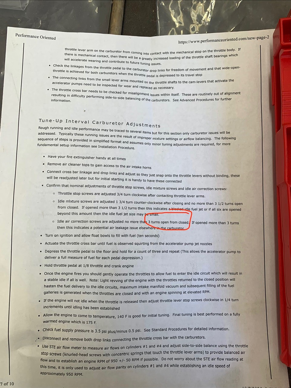

******UPDATE******
Getting better, still bucking but MUCH better.
Here is it idling after warming up
https://youtube.com/shorts/L67CQRup4bQ?si=EvWcujQjMgDava04
The problem I was chasing was a problem with semantics. I was following - like everyone told me - the Performance Oriented instructions
OK, this is interesting - there are 2 instructions as to WHAT you set the respective screw to and then, very craftily is inserted set this screw "Idle Air Correction" no more than 3 turns.........huh (IMG:style_emoticons/default/headbang.gif)
So, the other instructions are nominal and the third is No More.......UGH....so it IS my error, however......
I was just reading about aircraft maintenance manuals, there are 900 words you can use when writing them, this was initiated to try and remove any opportunity for confusion and there were many. Interesting.
I must have read that line in Performance Oriented 100 times and each time thought I should initially set it to 3 turns.
I set them to 1.5 turns and magic started to happen.
I will go around a few more times trying to get the last few gremlins out of the system, stay tuned.

sixnotfour   3 Half Turns equals 1-1/2 Turns.   Oct 4 2026, 08:41 PM
Superhawk996   I’ll go back and read all of Performance Oriente...   Oct 5 2026, 12:33 AM
Superhawk996   Page 56 from Weber Tuning Manual See the highligh...   Oct 5 2026, 01:05 AM
Superhawk996   Here’s the cutaway (from IDF guide) that shows y...   Oct 5 2026, 01:09 AM
Superhawk996   School of hard knocks stuff going on here but youâ...   Oct 5 2026, 01:38 AM
