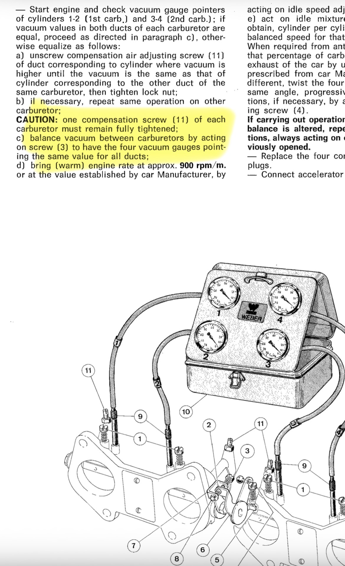

Superhawk996
post Oct 5 2026, 01:05 AM
Posts: 8,144
Joined: 25-August 18
From: Woods of N. Idaho
Member No.: 22,428
Page 56 from Weber Tuning Manual
See the highlighted caution statement.
Weber tuning manual link
https://www.lainefamily.com/images/WeberTuningManual.pdf
