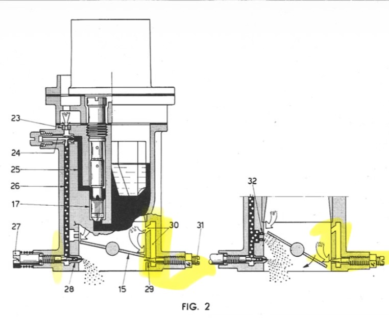

Superhawk996
post Oct 5 2026, 01:09 AM
Posts: 8,144
Joined: 25-August 18
From: Woods of N. Idaho
Member No.: 22,428
Here’s the cutaway (from IDF guide) that shows you what the air correction screws (31) are doing and why they reduce the vacuum on the idle circuit by allowing air flow from port (30) to port (29) to bypass the throttle plate at idle.

Superhawk996   Page 56 from Weber Tuning Manual See the highligh...   Oct 5 2026, 01:05 AM
Superhawk996   Here’s the cutaway (from IDF guide) that shows y...   Oct 5 2026, 01:09 AM
