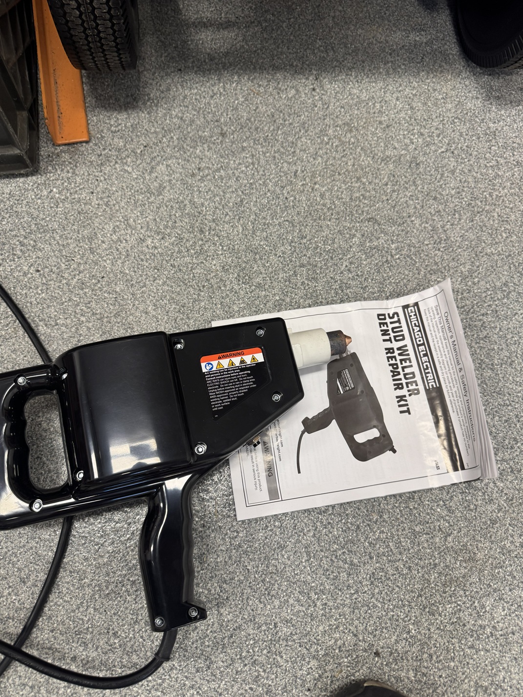

I picked up the HF Stud welder dent repair tool. Sorry no pics, but I was able to pull out the huge crease that was in the Drivers front fender where the impact folded the front fender a bit.
The slide hammer lock mechanism kinda sucks but it does work and the welder itself is great.

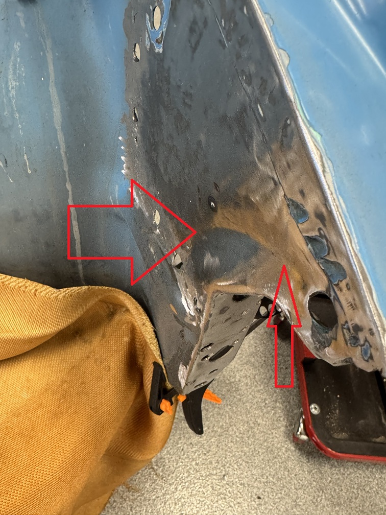

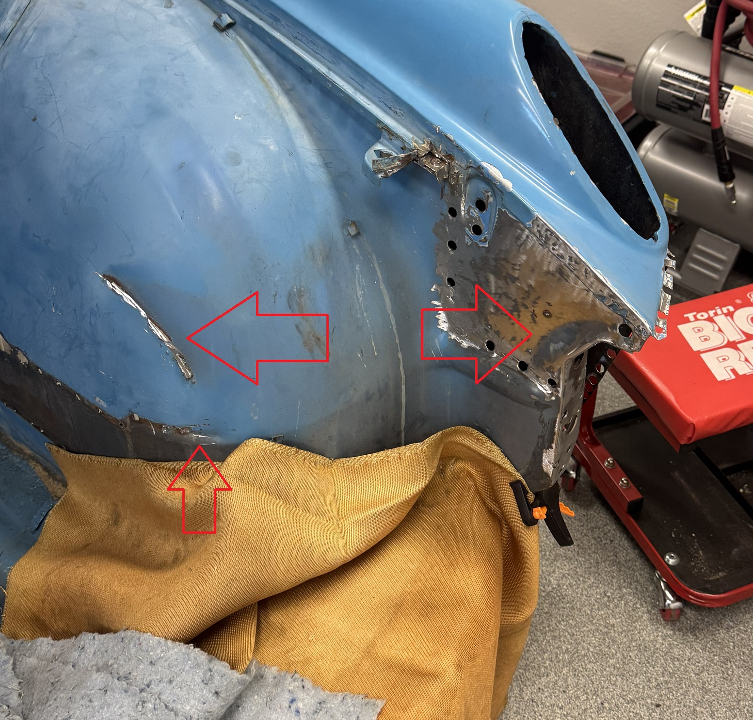

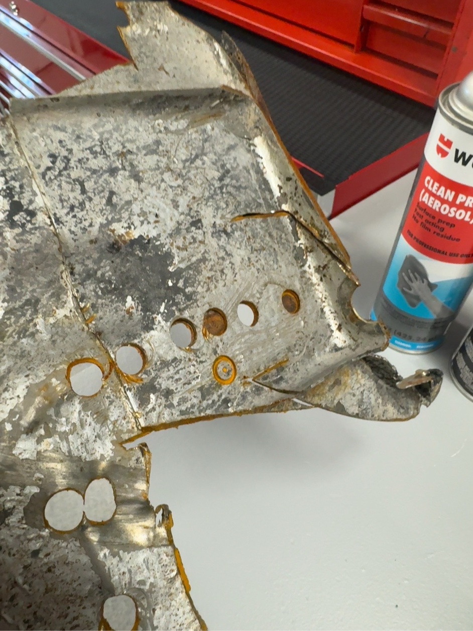

The drivers inner fender had a lot more damage than I initially discovered. The area where the brace attaches was bent inward quite a bit. So I've spent a fair amount of time hammering it back into place.
This whole side needed a lot of massaging and more to go:
Was also excited to use DYKEM spray. I took the paint off the inner fender, ground down the weld where the headlight bucket was and then sprayed the Dykem over the area. A light sanding with a foam sanding block revealed all my high and low spots.

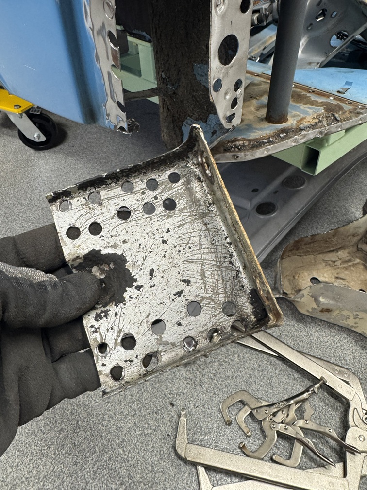

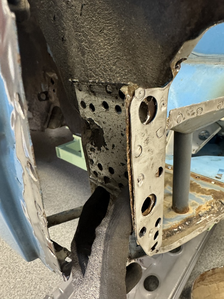

Also found that the early cars had this bumper support bracket.
Unfortunately I sawed through the drivers one before I knew it existed.
It's really hosed and it's pretty complex. If anyone has a donor car I could use this bracket (just cut out around it and I'll remove the spot welds)
Here it is on the passenger side mocked up on my 75. It will go a long way in reinforcing the front bumper. Most backdated bumper cars wont have this extra support.

Graydingo   More progress on the 914/6 GT tribute project thin...   Oct 18 2026, 10:01 AM
MikeK   Double post   Oct 18 2026, 10:53 AM
MikeK   It looks like you're doing a nice, thorough jo...   Oct 18 2026, 10:53 AM
MikeK   Seeing how you're currently using MIG and plan...   Oct 18 2026, 11:10 AM
Graydingo   Seeing how you're currently using MIG and pla...   Oct 18 2026, 01:54 PM
MikeK   Seeing how you're currently using MIG and pl...   Oct 19 2026, 10:36 AM
Graydingo   Are you installing flares? Yes I am. I got th...   Oct 19 2026, 08:56 PM
MikeK   I wish I could help you with that. I'm not th...   Oct 20 2026, 10:55 AM
