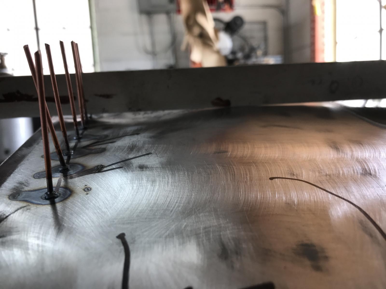

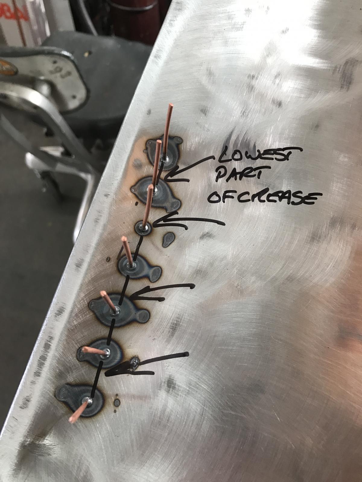

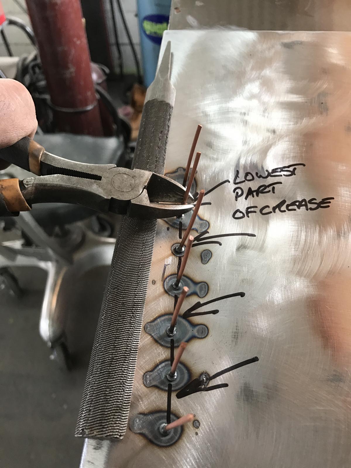

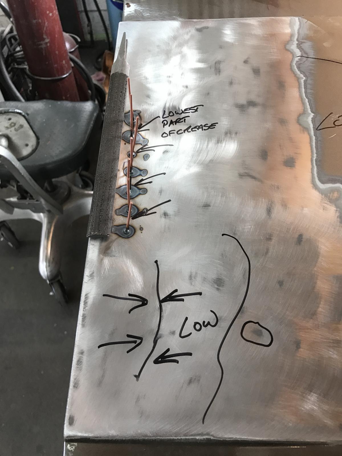

It looks like you're doing a nice, thorough job.
Just a bit of unsolicited advice... When using the Spitznagel tool, you might consider not using the slide hammer. It's really good at stretching the metal in an un-controlled manner. A better way is to use some side-cutters and a dull file or other improvised device to lift the dent rather than pull it with brute force. It's far more controlled.
