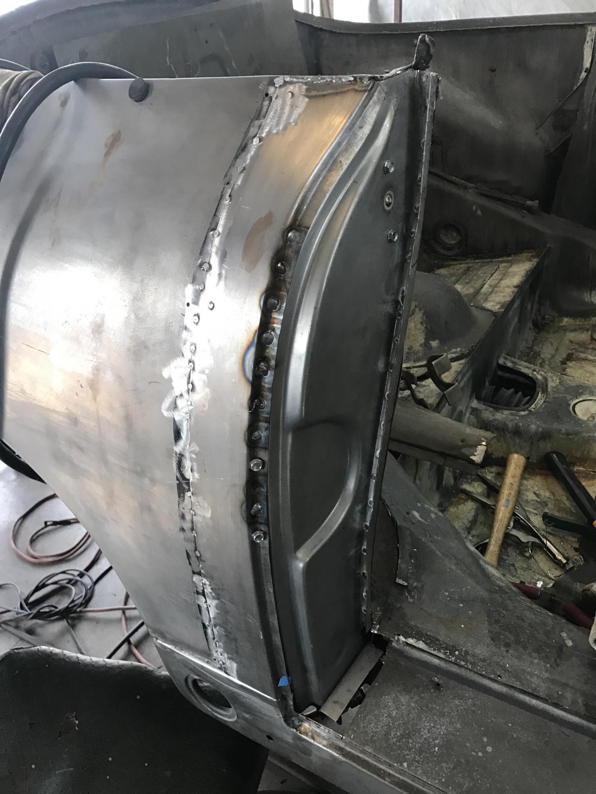

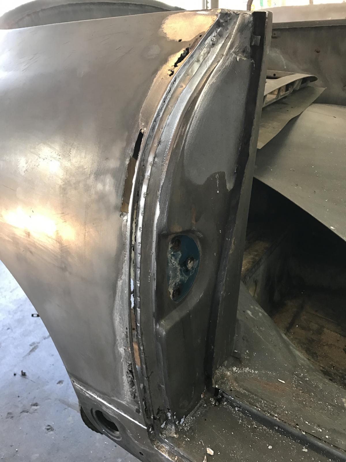

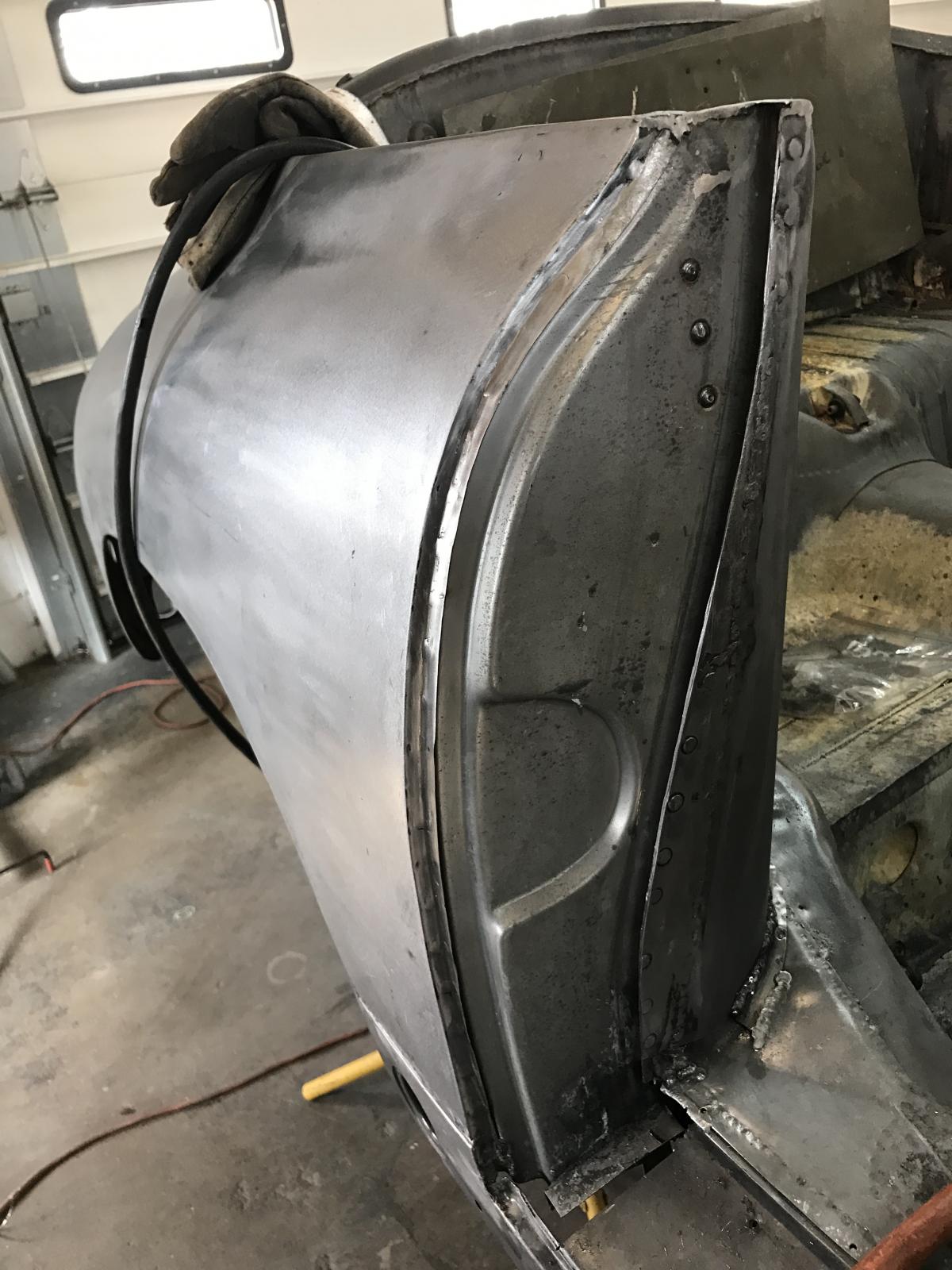

Seeing how you're currently using MIG and plan to use TIG in the future...
MIG is great for chassis and areas which you have no access to the back-side of the panel. It's not so great for general panel work that you'd like to metal finish to a point of not using filler. There's two reasons for this. A MIG weld tends to be harder and has a greater propensity to crack if hammered and a MIG weld will deposit additional weld material into the area that requires metal finishing.
Ideally, you want to have very good panel fitment and use either a torch or TIG to avoid laying more weld into the area which requires hammer work, otherwise the proud of the weld will be an issue.
this was TIG welded with little to no filler rod:

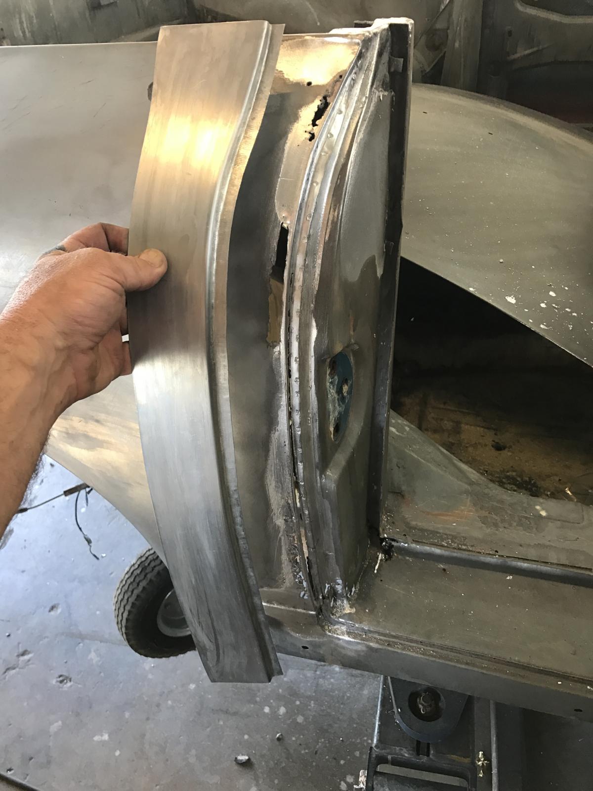

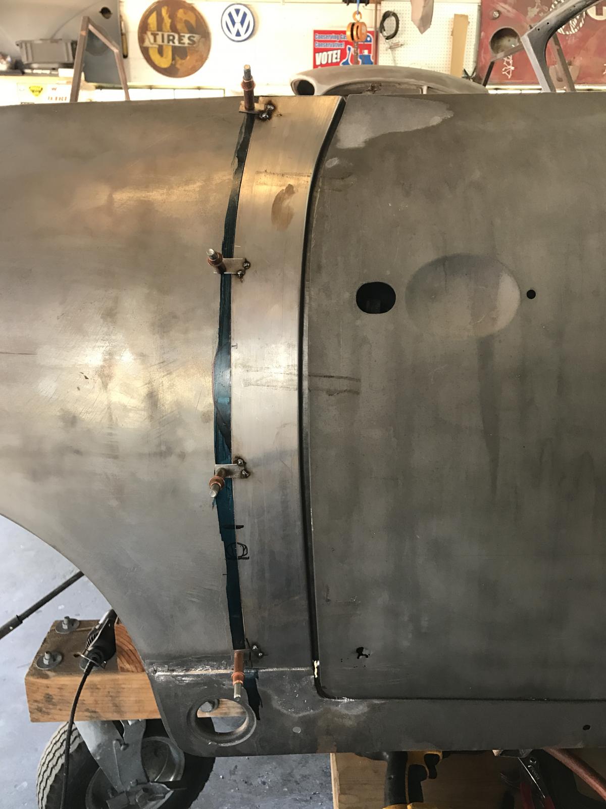

Then metal finished with hammer, dolly and file:
(IMG:http://www.914world.com/bbs2/uploads_offsite/www.thesamba.com-27418-1792343421.5.jpg)
Keep up the great work!
