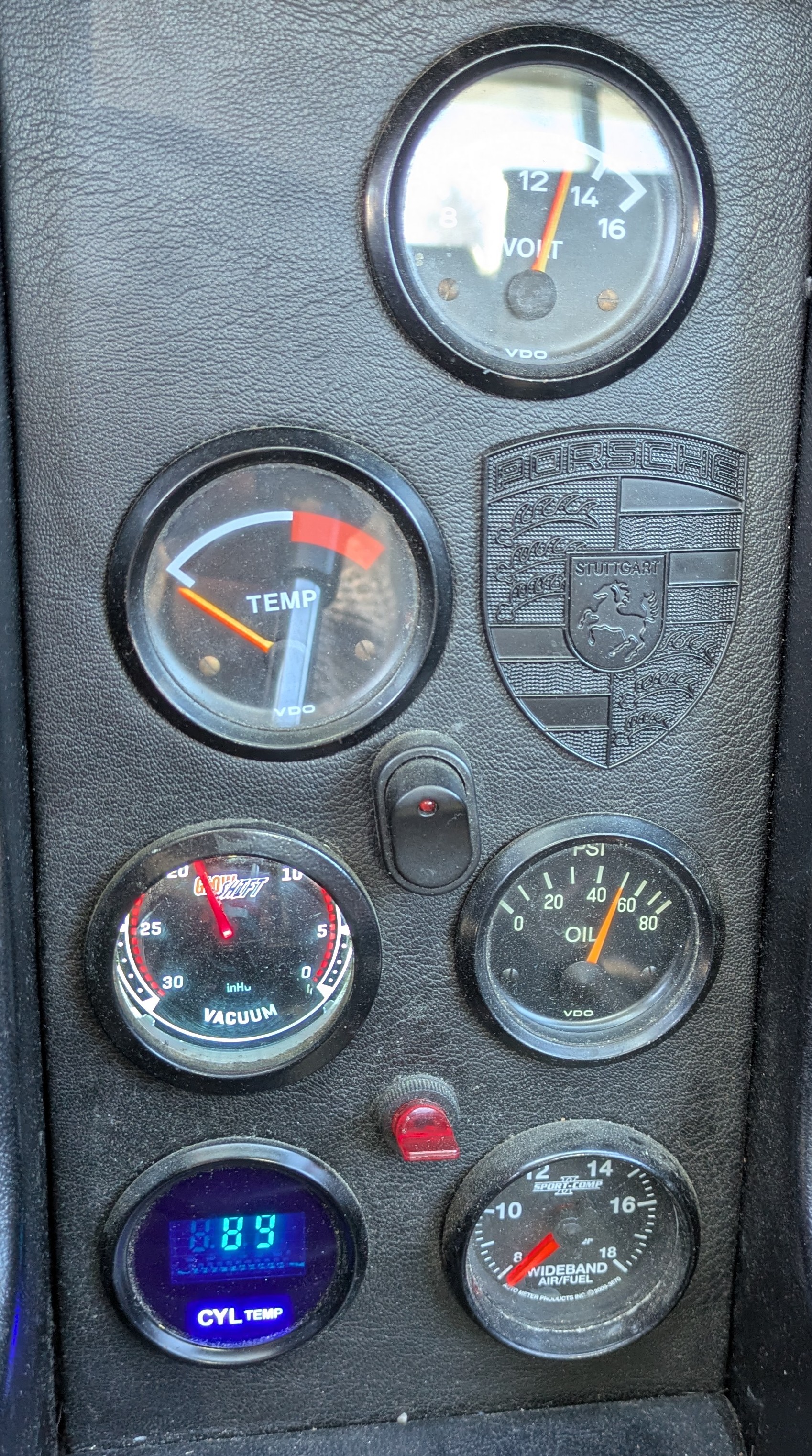

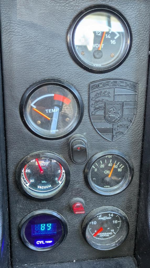

Hi Fellas: I do not have a CHT gauge, nor an AFR gauge. Or a fuel pressure gauge either.
This engine has been a 2056 since way before I bought it in 21. Ran fine, not lean for the thousands of miles I've driven it. At full temp yesterday it settled into a nice idle once I adjusted the idle screw on the TB. I want to check the timing again just to be sure,
Does the CHT control anything other than the AAR? And what would an AFR tell me?
emerygt350
post Oct 20 2026, 11:51 AM
Posts: 3,786
Joined: 20-July 21
From: Upstate, NY
Member No.: 25,740
QUOTE(robkammer @ Oct 20 2026, 08:43 AM) *
The factory CHT in the car for the fuel injection is of course controlling the 'extra richness' needed for cool engine temps. The AAR is entirely its own thing and is just a 'idle up' adjustment that should close very rapidly. It is literally equivalent to the step idle on an old choke system on a regular car. Does nothing but open the throttle (without actually opening the butterfly, instead it is a vacuum leak elsewhere).
The CHT and gauge that we are asking about is normally a ring placed under the #3 cylinder spark plug and run to the cabin for a gauge like a Dakota Digital CHT. This tells you how hot the heads are getting by monitoring the hottest cylinder (3 is hot due to the cooling design on the passenger side bank).
The afr gauge tells you how lean the car is running. You want it lean at cruise and rich at WOT. The values people tend to shoot for is 12 - 12.5 at WOT and 16 or so at cruise (some people like being richer at cruise, some don't). All of this affects performance and more importantly heat.
Prolonged head temps above 400 can result in dropped valve seats, burnt valves, and pinging from lean mixtures destroy your engine.
Without the CHT you don't know how hot the heads are getting (the oil does not respond very quickly to increased head temps so your heads can be over 420F in a minute or two and your oil can still be 140F).
Built motors with higher compression (even a 2056) can result in excessive head temps pretty quickly.
Some people prefer the stress free no gauge approach. I like to get in front of things before they go south.
This is right after start up so the AFR in the lower right is still waiting for a signal it likes from the O2 sensor.
