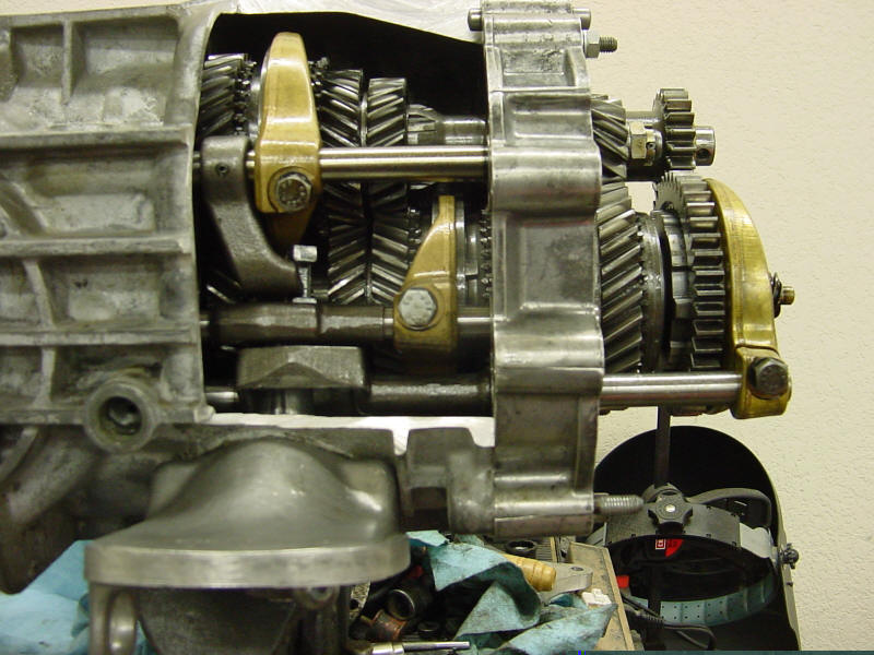

Here's what I did to a 901 transmission case to make it easier to adjust the side shift forks.....

Reverse
ClayPerrine   901 Transmission Cutaway   Feb 24 2005, 11:52 AM
ClayPerrine   Reverse   Feb 24 2005, 11:52 AM
ClayPerrine   First   Feb 24 2005, 11:52 AM
ClayPerrine   Second   Feb 24 2005, 11:53 AM
ClayPerrine   Third   Feb 24 2005, 11:54 AM
ClayPerrine   Fourth   Feb 24 2005, 11:54 AM
ClayPerrine   Fifth   Feb 24 2005, 11:54 AM

aircooledboy   Seems like some fluid might leak out thru that big...   Feb 24 2005, 01:12 PM
ClayPerrine   http://www.914world.com/bbs2/ht...   Feb 24 2005, 01:20 PM

brant   Clay, I'm confused... why do you need an adj...   Feb 24 2005, 03:40 PM

BigD9146gt   Brant, I made one of those from an old case a few...   Feb 24 2005, 04:04 PM
