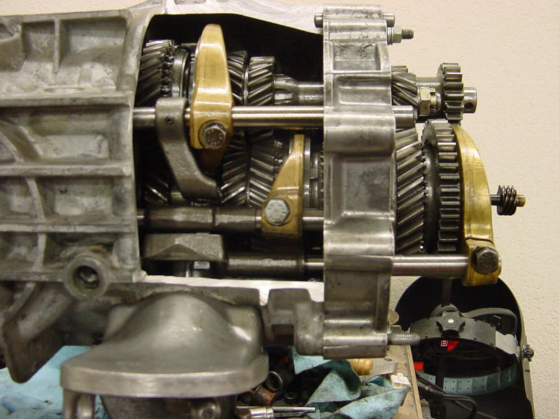

> 901 Transmission Cutaway, Makes adjusting the shift forks Easy!

Here's what I did to a 901 transmission case to make it easier to adjust the side shift forks.....

Fourth
ClayPerrine   901 Transmission Cutaway   Feb 24 2005, 11:52 AM
ClayPerrine   Reverse   Feb 24 2005, 11:52 AM
ClayPerrine   First   Feb 24 2005, 11:52 AM
ClayPerrine   Second   Feb 24 2005, 11:53 AM
ClayPerrine   Third   Feb 24 2005, 11:54 AM
ClayPerrine   Fourth   Feb 24 2005, 11:54 AM
ClayPerrine   Fifth   Feb 24 2005, 11:54 AM
opera guy   how do you put the piece you cut off back on? weld...   Feb 24 2005, 01:06 PM

aircooledboy   Seems like some fluid might leak out thru that big...   Feb 24 2005, 01:12 PM
ClayPerrine   http://www.914world.com/bbs2/ht...   Feb 24 2005, 01:20 PM
ClayPerrine   Betty just came in for lunch... She is just that ...   Feb 24 2005, 01:25 PM
BIGKAT_83   Damn good idea! http://w...   Feb 24 2005, 01:29 PM
redshift   I run my head like that so the brain I borrowed ca...   Feb 24 2005, 01:35 PM

brant   Clay, I'm confused... why do you need an adj...   Feb 24 2005, 03:40 PM
Aaron Cox   if clay could take all the pics from the same angl...   Feb 24 2005, 03:50 PM

SirAndy   <...   Feb 24 2005, 03:59 PM
BigD9146gt   Brant, I made one of those from an old case a few...   Feb 24 2005, 04:04 PM
jim_hoyland   Very nice pictures ! Always wanted to see what...   Feb 24 2005, 04:29 PM
