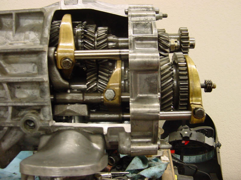

Here's what I did to a 901 transmission case to make it easier to adjust the side shift forks.....

opera guy   how do you put the piece you cut off back on? weld...   Feb 24 2005, 01:06 PM

aircooledboy   Seems like some fluid might leak out thru that big...   Feb 24 2005, 01:12 PM
ClayPerrine   http://www.914world.com/bbs2/ht...   Feb 24 2005, 01:20 PM

BIGKAT_83   Damn good idea! http://w...   Feb 24 2005, 01:29 PM
redshift   I run my head like that so the brain I borrowed ca...   Feb 24 2005, 01:35 PM

brant   Clay, I'm confused... why do you need an adj...   Feb 24 2005, 03:40 PM

BigD9146gt   Brant, I made one of those from an old case a few...   Feb 24 2005, 04:04 PM
jim_hoyland   Very nice pictures ! Always wanted to see what...   Feb 24 2005, 04:29 PM
