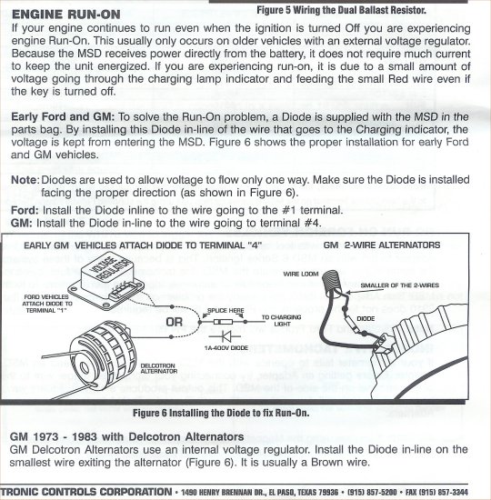

I turn off the key but the engine keeps running.
This is a new problem after adding the MSD.
Key turns off the power, I know, because I can hear the fuel pump turn off.
It eventually shuts off after turning the key off/on/off/on or revving the motor with the key off.
What should I do?

Aaron Cox   t dog i know the answer....i have the hyfire thi...   Feb 27 2005, 12:36 AM
redshift   Sounds like power is getting somewhere later than ...   Feb 27 2005, 12:37 AM
Aaron Cox   yep.... you need the diode! inline....   Feb 27 2005, 12:37 AM
Aaron Cox   install diode/resistor in line with SWITCHED posit...   Feb 27 2005, 12:39 AM

!   I'm having the same problem,,,,,looks as if th...   Feb 27 2005, 08:34 AM
0396   Mike, I'm not too experience with the electri...   Feb 27 2005, 08:59 AM
!   An internally regulated alternator has three wires...   Feb 27 2005, 09:12 AM
0396   Mike, Thanks for the reponse. I was concern that ...   Feb 27 2005, 09:19 AM
!   An on/off kill switch will work....but the diode w...   Feb 27 2005, 09:21 AM

!   Another comment from the 911 board....Rich Herzog....   Feb 27 2005, 09:30 AM
iamchappy   The easiest place to put it is spliced into the al...   Feb 27 2005, 10:12 AM
!   Since most of the Radio Crap guys are computer gee...   Feb 27 2005, 10:24 AM
trekkor   Joe, the purple/black wire is the tach wire. It no...   Feb 27 2005, 10:38 AM
!   Yeah the D+ wire needs it...."I" need from YOU.......   Feb 27 2005, 10:40 AM

trekkor   pic. MSD calls it a "100V/1A diode". KT   Feb 27 2005, 11:01 AM

trekkor   So can just place the diode in-line before the cha...   Feb 27 2005, 02:57 PM
Aaron Cox   i believe you want the diode inline with the switc...   Feb 27 2005, 02:57 PM
Sparky   Gee or read the manual they actually tell you that...   Feb 27 2005, 03:09 PM
trekkor   the MSD paperwork ( above ) reads differently. KT   Feb 27 2005, 03:09 PM
!   Just did the install....it works...   Feb 27 2005, 04:13 PM
trekkor   Where did you put the diode, Mike, I want to do th...   Feb 27 2005, 04:45 PM
Aaron Cox   <...   Feb 27 2005, 06:39 PM
!   Put it on the D+ lead to the bulb.....had a 50/50 ...   Feb 27 2005, 07:14 PM
trekkor   50/50 HUH? Not so good odds. I NEED the real stor...   Feb 28 2005, 03:13 PM
trekkor   Got it! Crimped on a terminal to each end wit...   Feb 28 2005, 04:08 PM
