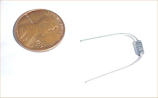

pic.
MSD calls it a "100V/1A diode".

trekkor   Pic coming... Take this. KT   Feb 27 2005, 10:55 AM
trekkor   pic. MSD calls it a "100V/1A diode". KT   Feb 27 2005, 11:01 AM

trekkor   So can just place the diode in-line before the cha...   Feb 27 2005, 02:57 PM
Aaron Cox   i believe you want the diode inline with the switc...   Feb 27 2005, 02:57 PM
Sparky   Gee or read the manual they actually tell you that...   Feb 27 2005, 03:09 PM
trekkor   the MSD paperwork ( above ) reads differently. KT   Feb 27 2005, 03:09 PM
!   Just did the install....it works...   Feb 27 2005, 04:13 PM
trekkor   Where did you put the diode, Mike, I want to do th...   Feb 27 2005, 04:45 PM
Aaron Cox   <...   Feb 27 2005, 06:39 PM
!   Put it on the D+ lead to the bulb.....had a 50/50 ...   Feb 27 2005, 07:14 PM
trekkor   50/50 HUH? Not so good odds. I NEED the real stor...   Feb 28 2005, 03:13 PM
trekkor   Got it! Crimped on a terminal to each end wit...   Feb 28 2005, 04:08 PM
