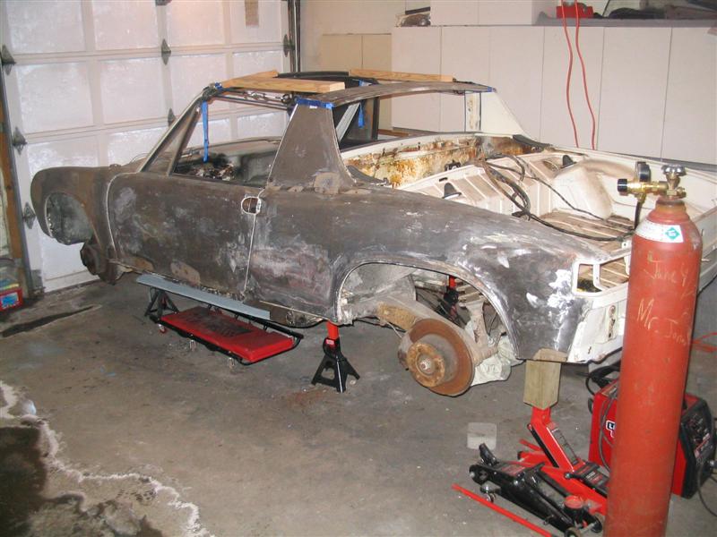

This will be my step by step driveway strip and paint thread. This may not be the way everyone will do it, but this is the way I will do mine. If you like it, you can do it this way also. If not, then you can take it to a body shop and pay $3k to $5k for a paint job. You could also do different variations and run the cost up. I will post what I spend on this entire process. Some have said its like hitting your self in the head with a hammer, ok, this will be my first smack in the head.

QUOTE (dinomium @ Mar 8 2005, 11:59 AM)
What brand oh stripper are you using? Ugmo needs a bath in it!! PO used that nice faux stone paint in BOTH trunks...
I am going spray in the garage with a home made air exchanger. Then I can really use the " I Forgot" Excuse! (IMG:http://www.914world.com/bbs2/html/emoticons/beer.gif)
I've used two brands of chemical stripper (Aircraft Paint Stripper 495-1 by Morton and Tal-Strip II by Mar-Hyde) and they both worked great. I got the Morton stuff from an automotive paint supplier and the Mar-Hyde from a FLAPS. You can spray the stuff, but it actually works better to brush it on.

skline   First application of the chemical stripper. Try no...   Mar 8 2005, 12:55 AM
ovilla   Please check your town's ordinance for this fi...   Mar 8 2005, 12:55 AM
skline   Second coat of stripper, same as the first. Howeve...   Mar 8 2005, 01:00 AM
skline   Indecently, the stripper is neutralized in water s...   Mar 8 2005, 01:06 AM

Aaron Cox   scotts progress: k, Second day of working on the c...   Mar 8 2005, 03:43 PM
Aaron Cox   The rust I need to fix, not sure how yet, but I wi...   Mar 8 2005, 03:45 PM

skline   End of 2nd day results. My goal is to have this th...   Mar 8 2005, 08:25 PM

wrpspddrvr   Is the gray stuff Bondo? I was under the impressio...   Mar 8 2005, 08:45 PM

xsboost90   ahh yes, good old stripper. The grey is primer app...   Mar 8 2005, 09:09 PM

skline   Actually, the stripper only needs to set for about...   Mar 9 2005, 08:37 AM
!   Have you tried putting thick saran wrap on top to ...   Mar 9 2005, 08:39 AM
skline   That does work but I didnt want to make a bigger m...   Mar 9 2005, 08:44 AM

skline   Well, I had a few visitors today and got quite a b...   Mar 10 2005, 02:40 AM
skline   Another shot in a different spot.   Mar 10 2005, 02:41 AM
skline   There were dents where the studs are welded on, th...   Mar 10 2005, 02:45 AM
skline   The worst dents to remove in the car.   Mar 10 2005, 02:46 AM
skline   The part I just happened to have on the side of my...   Mar 10 2005, 02:47 AM
skline   The drivers side rear is riddled with a flock of l...   Mar 10 2005, 02:51 AM
