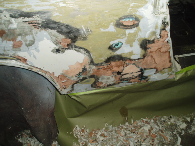

This will be my step by step driveway strip and paint thread. This may not be the way everyone will do it, but this is the way I will do mine. If you like it, you can do it this way also. If not, then you can take it to a body shop and pay $3k to $5k for a paint job. You could also do different variations and run the cost up. I will post what I spend on this entire process. Some have said its like hitting your self in the head with a hammer, ok, this will be my first smack in the head.
First shot, before.

ahh yes, good old stripper. The grey is primer applied before the white was put on. the pink, green and blue would be stuff that we would call "bondo" or filler. IM alittle further than that, doing body work now. Mine had been stripped once before, and its been sprayed with self etching primer-green- and then some filler primer-grey.
i would say that maybe your quarter was resprayed green at some point before someone painted it white. I doubt the factory would have used that much bondo.
