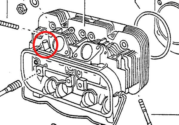

it isn't very much, but a bit of oil is being sprayed up in the engine compartment. i got to drive the teener a good bit today, and when i checked the oil midway, i saw evidence of oil being sprayed up against the rain tray. (IMG:http://www.914world.com/bbs2/html/emoticons/unsure.gif) not much, but spattering about on top of aircleaners, very small puddles on top of engine, that sort of thing. couldn't see from where it came. (IMG:http://www.914world.com/bbs2/html/emoticons/confused24.gif)
ran like a top, btw. (IMG:http://www.914world.com/bbs2/html/emoticons/driving.gif) (IMG:http://www.914world.com/bbs2/html/emoticons/aktion035.gif)
any ideas? is it bad, and if so, how bad?

Each of the heads has a vent pipe that connects to the crankcase ventilation system. These pipes press into the head, but on my car one was loose, and the pressurized spray was blowing out around the edge of the pipe. I don't know if the vent pipes were used in all cars or only the later models. Mine was a 74 2.0L converted to 2056 plus carbs.
